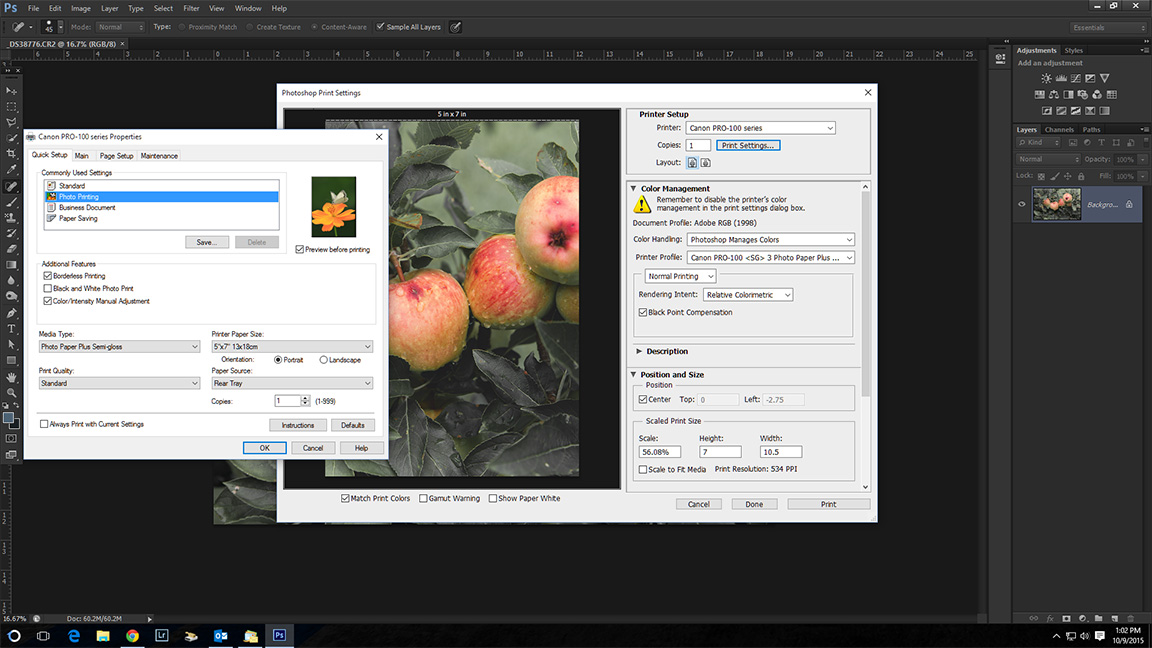

First, you must not let the printer set anything. Turn off every bit off control it has. You can do this with the Canon My Printer under the Printer Settings tab. Do you know how? I will guess, yes, for now but if you don't get back to me.
Second, you need to have your photo editor (like Photoshop) handle all the settings and color matching. You know how to do this? I prefer Photoshop and I use AdobeRGB color space.

Also opn the Photoshop print settings window do you click the bottom left hand box thatv says "Match Print Colors"

Here are the settings I use.
