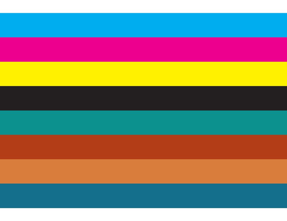

Our "new to us" imageRUNNER ADVANCE C5235 has an odd issue that even our copier maintenance tech can not solve - colors from the left to right of the sheet are not printing consistently. The most apparent is magenta, which looks orange/yellow on the left and full magenta on the right. Typically, I am printing images from acrobat with a file exported from InDesign (or other Adobe Apps) in PDF format. OS is MacOS Sonoma 14.4, driver is the latest from the Canon site (UFRII_v10.19.16_mac). We have a copier maintenance company that has checked the unit, cleaned everything, replaced a transfer roller, run their calibration and just told us, "must be an issue with your driver" and walked away from it. Any help would be greatly appreciated.
This photo shows the color shift (noticeable in all the other colors). The bottom 4 colors are our brands colors:
PXL_20240311_145129382.RAW-01.MP.COVER~2 Medium.jpegPXL_20240311_145129382.RAW-01.MP.COVER~2 Medium.jpeg
This is the digital jpg version (Canon won't allow for pdf upload)
