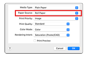

I believe this is where I should be setting that on the computer side, but I'm not able to select cut paper for some reason.

Hi macberns,
You have to specify the paper source on your computer. Usually, selecting the paper/page size with "(cut sheet)" listed behind it will set your paper source as cut sheet. You should also be able to select Cut Sheet for the paper source in the Quality & Media section (see below). If this doesn't work, let us know what version of Mac OS you're using, and we can give some additional steps.
