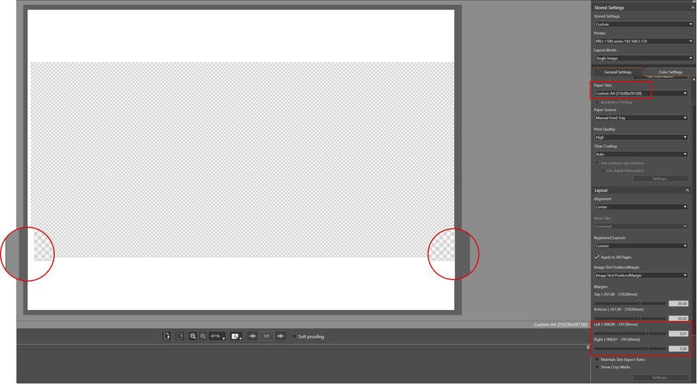

07-26-2026 12:50 PM
Hello,
Were you ever able to solve this problem? I’m experiencing the same issue with a Pro-1100 and custom paper sizes (the 1100 can't even print roll paper).
As soon as you define a custom paper size, the printable area shifts to the right.
As you can see in the screenshot, the margin is set to 5 mm, but there is no margin on the right side, because the center option uses the printable area as its baseline instead of the center of the paper.
The paper size is a custom-created A4 format, just to test this issue.
