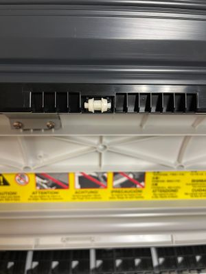

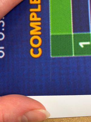

Looking for recommendations! Recently our Canon iPF8400se has been experiencing track marks. They seem to be mainly at the beginning of the print if we hold the paper down as it comes out. Otherwise, they carry down the whole print.
I have run the print head cleaning and also manually cleaned the print head which was just replaced a few months ago and suspect that the issue lies with these white rollers pictured below. We have cleaned the rollers and it still continues.
The track marks seem to only be an issue on our vinyl as we have run the same job on photo paper and there were no issues. We still have yet to test our larger roll of vinyl and matte paper, but it is on the to-do list. Suggestions would be much appreciated!
