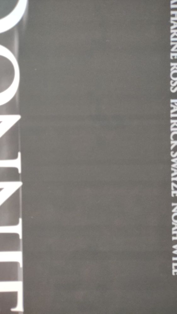

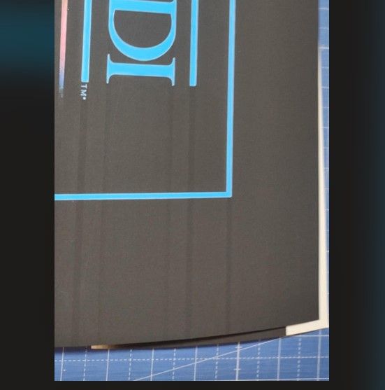

I’m experiencing an issue with my Canon TM-200 plotter when printing on matte paper (230 gsm). The problem manifests as dark streaks or smudges, particularly noticeable in areas with color transitions (e.g., white to black) or in solid dark regions.

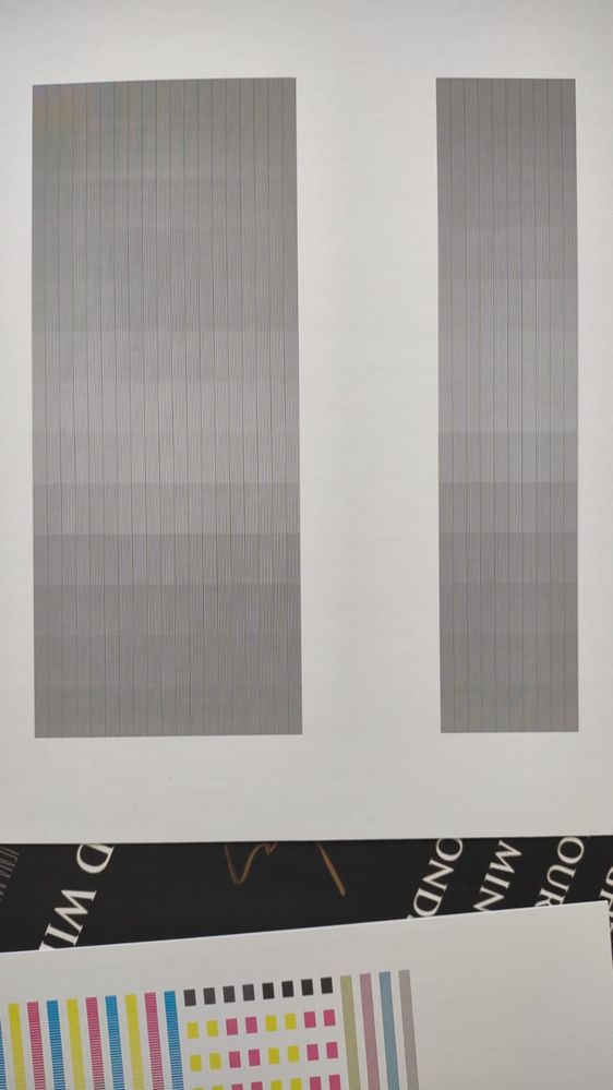

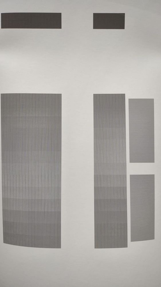

I am attaching a few pictures from maintenance, including automatic head print adjustment done on an A4 220 gsm matte sheet, paper feed adjustment on an A4 sheet, and on 80 gsm regular coated paper. I am not sure how to evaluate the results, but I think I see some banding in the shades of grey during the paper feed adjustment test. Any help or insight would be greatly appreciated.

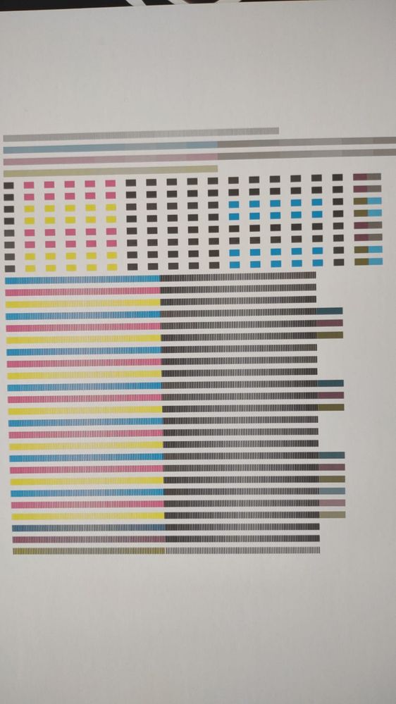

One thought came to mind: could I have accidentally put photo ink into the MBK slot if they were mislabeled? Or could it be an issue with the printer head? However, I just performed a nozzle check, and it looks fine to me. Pictures attached. Thanks!

Your nozzle check does indeed look correct. The question about wrong ink is hard to do as the cartridges are keyed. Could you attach a picture of the MBK cartridge and label?

Using non-canon inks can cause many different weird issues as they are not 100% formulated to work with the printheads and the Canon ink system. I would get a set on OEM stuff and flush the system like you said. As for the head, I would hold off only as a last resort. The age isn't that bad and that nozzle check looks good. If possible, google how to perform a "Service Nozzle Check". This has much more detail and can give you better incite into what is going on with the head.
