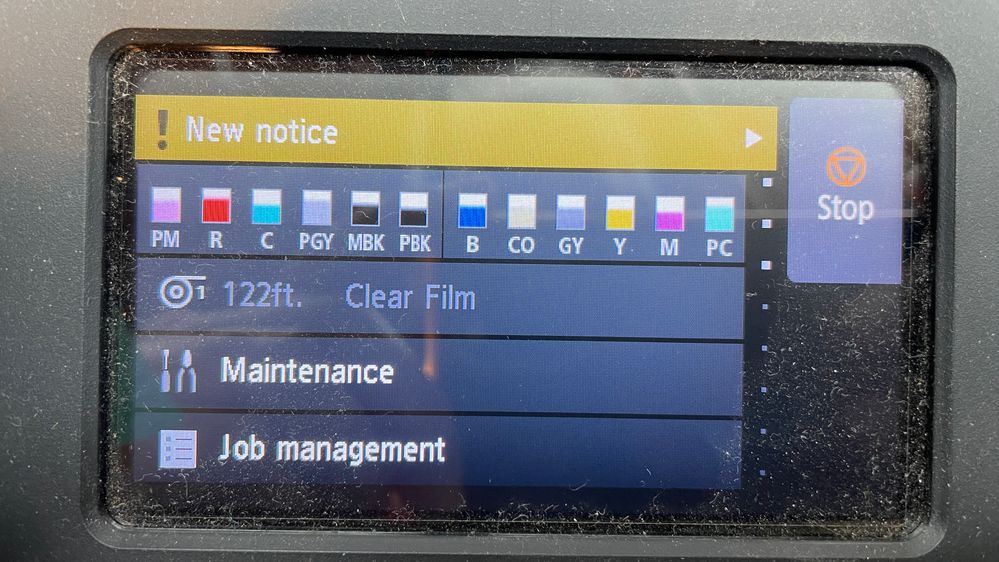

Hi, I have been using a roll film with white tape on the edges for several years but now when I try to print an image the printer error message is: "Cannot detect the paper size. Move the release lever and reload the paper". I have done this 3+ times with no change. The error does not show up with plain white paper. I am printing the same image with the same settings from photoshop. I have deleted and reloaded the printer from my Mac. When I initially load the film, the printer has no problem detecting what it is, "clear film", it's only when I try to print that the error shows up. The "how to clear" does not help. I have also noticed that the roll loading does not align the paper with the orange line. (not sure if thats a problem or not) See photos. Any suggestions? Thanks!
UPDATE: when I load a clear sheet manually the error does not appear.

12-03-2024 03:05 PM
I see a Maintenance selection on the photo of the printer LCD. What happens if you select it?
12-03-2024 04:30 PM
Just the standard stuff about head cleaning / alignment, calibration etc. Nothing about paper width detection...
12-03-2024 05:02 PM
OK Found it under the Advanced Paper settings for the specific paper. Turned off the "detect paper size" and had to set paper size manually but it worked. Thanks again. I had never dug into the printer menus that deep!
