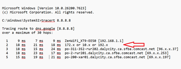

Did you see the blurb in my first reply in regards to double nat?  If you have devices that exist on multiple LAN segments, then It appears you have two devices handing out DHCP addresses or an improperly configured cascaded network.
It's very easy to test for this using the tracert command from a command prompt.
If the first 2 hops contain a private IP address, then a double nat or improperly configured cascaded networks exists.
These are the only explanations for 2 private IP LAN segments.

Yep, the whole issue was that compA and compB were inadvertently on separate branches of my home network. Also, if the printer ever gets connected to another branch [initially, or my manual connection option], devices on the other branch will not find the pinter.
     Should probably modify guest network so that it does not use the odd branch (172.27*) but stays on main branch (192.168* in my case).
