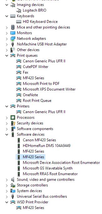

I tried the utility you provided. While I see a product there, it does not seem to work when I try to scan. There was no network setup at any point which would point the driver to the IP address of the device.
A screenshot from the Device Manager:
I would like to note that started off with just the Canon drivers, and recently ran the autodetection which added the Microsoft drivers/devices (WSD Print Provider, MF420 software devices, etc). The "Canon Generic Plus UFR II" device is the printer and it works great. No luck with anything scanner related.
Everything works like a charm on my Mac, and iPad though. So this is not a hardware or device config issue.
