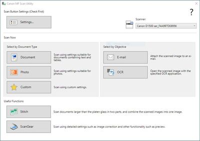

Hi
I have downloaded the software for my printer and have installed the printer. I can print; however, I can't scan. I have the Canon MF Scan Utility, however the copier that shows up on the scanner is not the one I have. I checked the drop-down list, but my printer doesn't come up. Please help. I have tried all of the suggestion in the manual. I have also tried to delete this Printer and I been successful, however this might be hidden somewhere deep because it keeps popping up even after i uninstall the program. Please help.

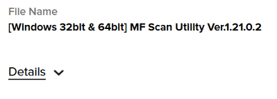

You appear to have the correct software installed, but to use it, You have to have the MF scanning utility version. 1.21.0.2.
However, you're not going to be able to do anything with the MF455dw until the D1500 system is changed or removed.
Is the D1500 an old device, a printer that you owned previously or had installed on the system?
Is it still connected?
05-25-2024 01:02 AM
Hi
Yes this is a previous printer we had. Its not connected anymore and I have tried to uninstall it, however it keeps saying it cant be deleted because it is in use.

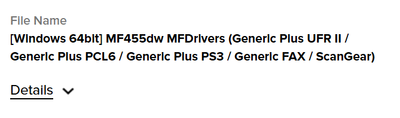

Download these two files:
Install in the order I've listed, Retest. Please post your results.
