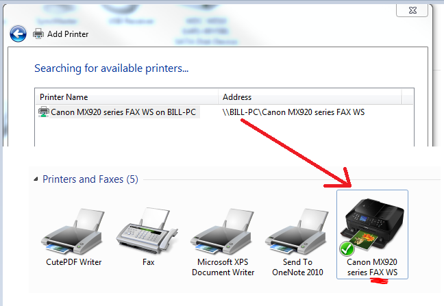

So, ok, I'll start over. I re-connected the printer to my WiFi network, fine. I remove the printer and fax, and then "Add Printer". When I do that, it only finds "Canon MX920 series FAX WS", but it installed ok.
- Why is it only the FAX ??? And what the heck is "WS" ???
Now, when I print, there is an option in the drop-down for FAX WS, Printer WS, and MX920 Series Printer(where did THIS come from ???)
So I can print now . . . haven't checked my wife's printer, and we'll see in a day or two if the printer goes offline . . .
also, why is the FAX WS the only device in Printers ? Why isn't the Printer there ? meaning I can't set the printer as default . . .

02-01-2016 12:06 PM
Michael,
thanks for the reply. My printer is working fine including the wireless (after I re-configured everything). My wife even re-connected without issue, and I got another big hug ![]()
My only issue, which is minor, is why is there only 1 device in printers (FAX WS) ? Since I'm operational, I don't see a need to call, but thanks !
