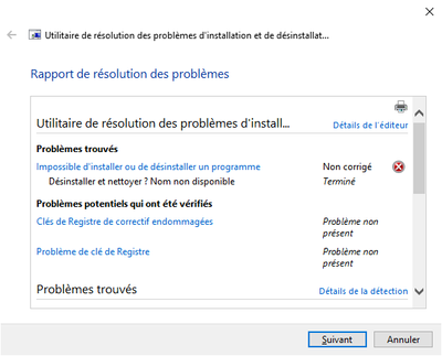

Hello RIck,
Unfortunately, the MS Uninstaller Tool did not work.
@chrlsrchrdsn How did you manage to uninstall MF Toolbox 4.9?
