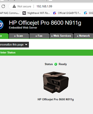

Greetings,
Both, please consider making the following changes. Assign your printer a static or reserved IP address on your network. Do this on your router.
Verify communication. Open a webrowser and enter the printers IP address. Its webserver should display.
Use a command prompt and ping the printer's IP address. It should reply.
Windows:
Open Settings > Control Panel > Device and Printers.
Find your Canon printer and right-click on it. Select Remove Device from the context menu.
Now use the Add Printer button above. Select My printer is not listed below the window (even if you see it there).
Select Add by TCP/IP address
Enter the IP address of the printer and select next. The printer will install.
Why do this. Once the router is told to give this IP address to your printer and no other device, it will never change. It doesn't matter if it goes to sleep, gets turned off or you go on vacation. When you return, the IP you set will still be assigned to the printer. Any network device, phone, iPAD, PC, MAC will always be able to find the printer at its static [destination] IP.
Example:
My printer's IP is 192.168.1.99
Results of ping command:
C:\Users\admin>ping 192.168.1.99
Pinging 192.168.1.99 with 32 bytes of data:
Reply from 192.168.1.99: bytes=32 time=4ms TTL=255
Reply from 192.168.1.99: bytes=32 time=2ms TTL=255
Reply from 192.168.1.99: bytes=32 time=3ms TTL=255
Example Browser:
Think of it in relative terms.
Your router has a pool of addresses (example)
192.168.1.1 ~ 192.168.1.255
.1 is the routers address so .2 ~ .255 are useable
I have mine limited to 50 available IP's
192.168.1.100 ~ 192.168.1.150 which means I can assign static or reserved IP's to any devices
above 192.168.1.150 ~ .255
Below 192.168.1.2 ~ .99 to a device connecting to my network. My router does not hand out IP's above or below this range. In this example, my printer is assigned 1.99, NAS1 1.4, NAS2 1.5 and a range extender 1.90. The router will never give other devices IP's in these ranges (above or below the pool of IP address I have allocated for DHCP.
Static IP's are a one and done set up. You will never have to wonder what a devices IP address on your network is again.
