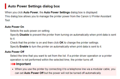

These scenarios can usually be mitigated by changing the printer's power settings. Please see the IJ Printer Assistant Tool
Canon : Inkjet Manuals : TR4700 series : Canon IJ Printer Assistant Tool Description
Select Auto Power. These are the options that can be modified.
Please let us know if this helps, or if one of the other scenarios better fits the behavior you are experiencing.

Shadowsports, I found the auto power on/off settings on the printer display and set it to auto power on so hopefully this resolves the issue. It was under ECO settings. Thanks for the tip. Do you know if there is an app for my android phone, tablet or Chromebook that accesses the printer's setting when all is on line with the network?
