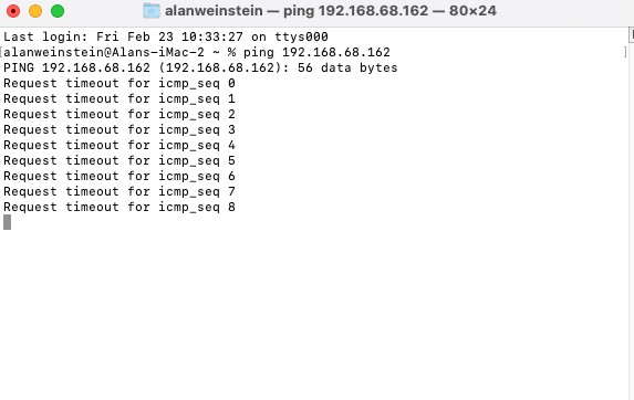

First you are amazing.  Realize that the printer is connected to the wireless and if I use wireless on my Mac it works perfectly.  The problem is I prefer having the Mac direct connected via ethernet and when I do that the printer shows offline.  I went tot he lCD screen and printed out 3 pages on Network configurations and none of the ones I typed in the terminal showed anything.  I assume I was supposed to type the word ping first as you did.  I'm calling spectrum for the login.
So I figured out the problem.  The Mac was connected directly into the Router while the wireless was running via the mesh network.  So I plugged the Mac directly in the the mesh network and it solved the issue.  Your generous input put me on the right path so thank you for all of that.
