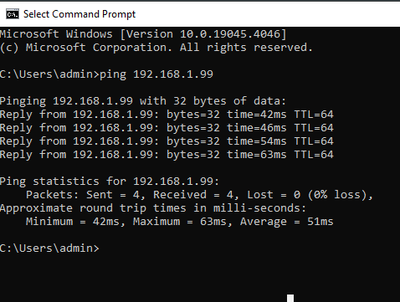

You can ping the IP of the printer (once known) from Terminal. This is in the Applications > Utility folder. Check Finder for this.
My printer's IP is 192.168.1.99... it would look similar to this:
The successful replies indicate the computer can communicate with the printer. A firewall or 3rd party anti-virus might keep a printer from being detected or communicating properly. (Not sure it applies, just mentioning it). We can continue once you have verified connectivity between devices on your network.
