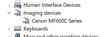

I however only have one device entry under my Imaging Devices for the 644 & 656.  I'm running 23H2 on this system so its not affected.
Example

These are instructions for one listing of a Canon series printer under Imaging Devices in Device Manager. But they apply to all duplicates if you have more than one. For example, if you see several duplicate entries:
Canon MF650C Series
Canon MF650C Series
Canon MF650C Series
Etc.
After installing the above: mastersetupv110 do the following:
  1. Goto Device Manager
    1. Expand Imaging Devices
    2. Right click on the Canon MF650C Series and select “Disable  Device”. If your Canon is listed more than once, disable each one.
  2. After you have disabled the Canon device right click on it again and select “Update Driver”
  3. Click Browse My computer for drivers.
  4. Click Next
  5. Click Let me pick from a list of available drivers on my computer
  6. Your printer/scanner should be in the list, make sure it is selected, then click Next.
  7. A message should appear, Windows has successfully updated your drivers
  8. Do this for each duplicate Canon device listed under Imaging Devices.
  9. Exit the Device Manager and (Required) reboot your computer.
  10. The Canon MF Scan Utility should now be functional.
