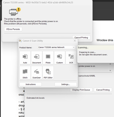

Hello;
TS5300 is printer with scanner.
Scanner works with no problem by wifi - there is wireless connection.
Printer - always problem, printer offline.... after driver reinstallation printer works for couple of days and again the same.
How to fix it?
I use windows 11.

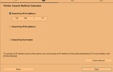

Greetings,
Welcome to the community. I suggest you assign a static IP address for the printer on your router. Then uninstall the printer from your system, restart and re-add the printer as an IP printer. Assigning a static address will ensure persistency. This only has to be done once and is used to ensure devices that do not come and go from the network always receive the same IP address. This will keep you from constantly having to reinstall the device for consistent communication.
07-22-2025 03:44 PM
I cannot find such an option on the router - router has been configured by internet providor.
And I did not find this requirement while I bought the printer.
Just to clarify: scanner and printer is one device. Scanner works properly - connects with no problem. So it is possible. Device is in network.

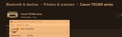

07-22-2025 04:16 PM
and unfortunately. static IP address added on router. The same IP address assigned on printer.
Windows added toe printer properly.... and cannot print anything.
What can I do to use this printer as normal user?

Open a command prompt and ping the IP address you believe is assigned to the printer. Does it reply?
If you enter the IP address into the address bar of a web browser, does the printer's web server display?
I'm also going to need the exact model of your printer. TS5300 is a series not a model
What build Windows 11 are you using? 24H2?
