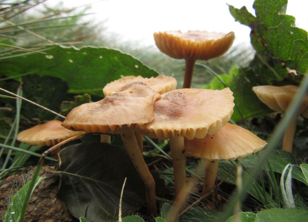

I have Canon SX740, I bought it after SX620 because I though I will make better (clearer pictures), and mainly because I wanted to make macro shots. However, they turn out very often blurry (with lot of noise and edges not sharp enough). I tried programme and manual on upper button, wtih MF macro, and with different ISO values.
Also, any photos of landscape are just full of noise and blurry, no matter if auto / programme /scene (with normal focus selected). I think my photos were better with older model of camera. What I am doing wrong? IMG_0003.JPGIMG_0065.JPG

2nd Photo:  This image is an extreme closeup of a subject.  Again, the laws of physics are working their hardest against you.  Instead of heat rising off a badly of water, this time it is the limitations imposed by the DOF, “Depth of Field”, of the shooting conditions.  Do a web search on the phrases I put in quotes.  But I will summarize it here, for you.

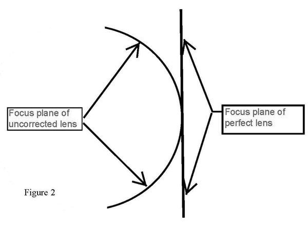

When a lens is focused; perfectly focused objects fall along a virtual 2D sheet in space known as a “Focus Plane”.  A theoretically perfect focus plane is flat sheet in space.  Real world lenses come close to that ideal, but not exactly.

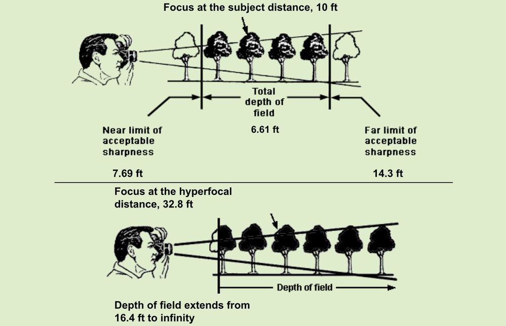

Objects that fall along the focus plane are in perfectly sharp focus.   Objects that are slightly behind or in front of the focus plane will also appear to be in very sharp focus.  As the distance from the focus plane increases, objects will no longer appear as sharp as closer objects.  Depth of Field describes the total distance from in front of the focus plane to behind the focus plane where objects are “acceptably sharp” to the human eye.
The image below is a screenshot from a web site known as dofmaster dot com.  The indicated distances are for illustrative purposes only.  The actual working distances can vary widely, depending on the size of your image sensor, the focal length of your lens, and the distance that you are focusing to your subject.
Photos like your extreme closeup fall into the category of macro photography.  At “macro distances”, the DOF becomes much smaller, dramatically smaller, in fact.  The DOF [can be] as small as one inch, or even MUCH smaller.
I suspect this is the issue with the 2nd photograph.  You are so close that the camera cannot capture the entire scene in sharp focus.  This is normal.  If you moved forward or back by a fraction of inch after the camera focused, but BEFORE you took the shot, then subject can and will be OOF, out of focus.  [At these close close distances, you need to be perfectly still or you need to use a tripod.]

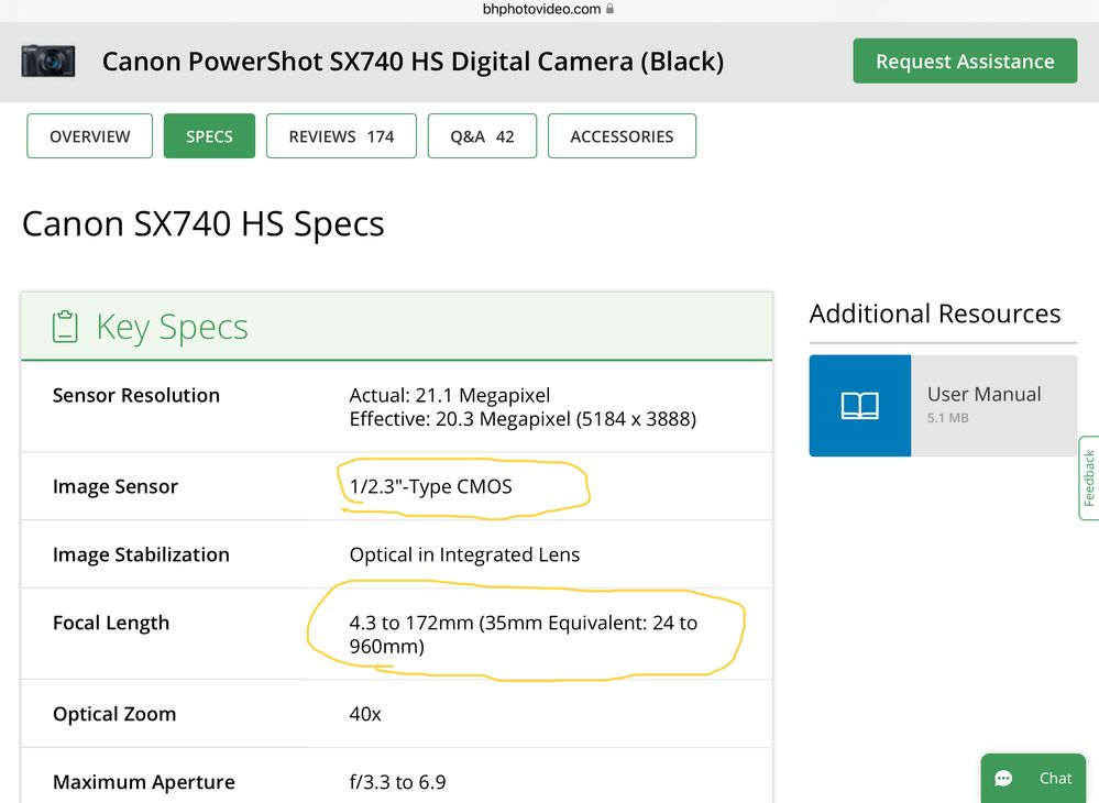

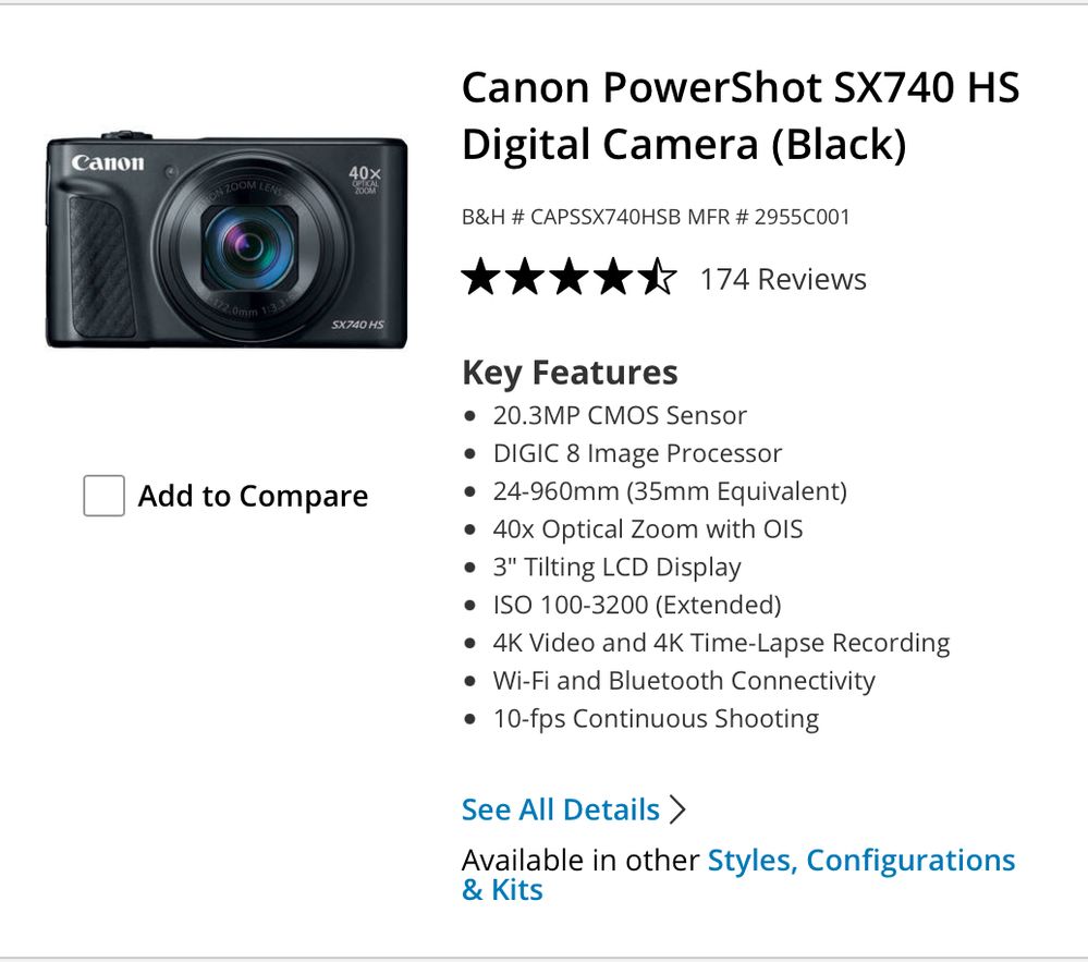

I looked up your camera’s specifications at B&H Photo Video’s web site.  Your camera uses an image sensor that is 1/2.3” in size.  It has a zoom range of focal lengths that goes from 4.3 to 172 mm.  The maximum aperture range is f/3.3 to f/6.9.

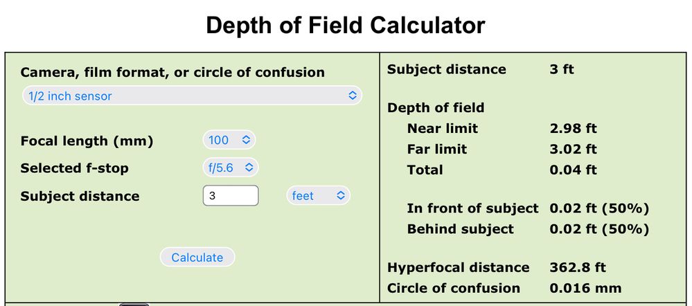

I wanted to illustrate just how small DOF can become for your 2nd image.  The DOF calculator does not have your exact image size so I selected a focal lengths and apertures in the middle of the range of your camera.  I chose a distance of 3 feet for not better reason than “because”.
These are the specs of your camera.  I had to approximate your sensor size as 1/2”.
This is the result of the DOF calculation.  Note how small the Total DOF distance becomes.
The total DOF is 0.04 feet, which is about 1/2 an inch.  In this made-up scenario, ff you move forward or back by as much as 1/2 inch, then your subject would be OOF.

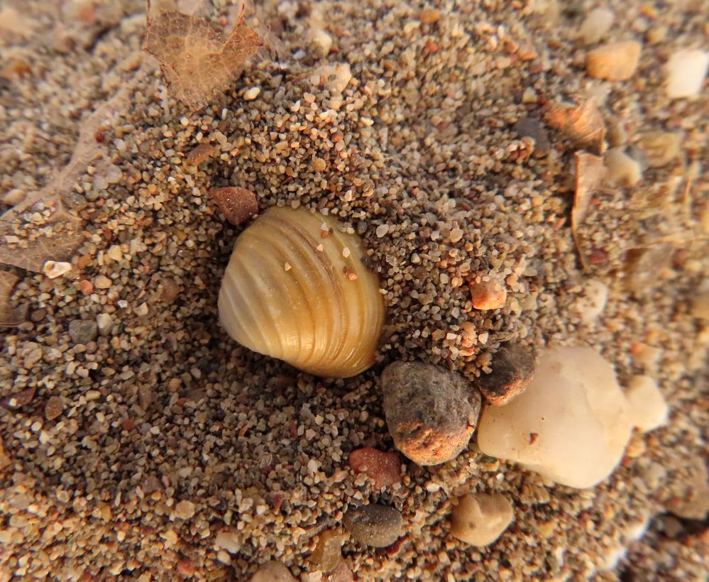

As for macro photos, my camera is suppose to make good macro photos, it says in specifications "Closest Focusing Distance: 1 cm (W) from front of lens in Macro", and I selected this model precisely because of that, but I have the feeling that with previous model (sx620) photos were better. I tried different settings of focus and programme options; sometimes I am satisfied with the photos - such as those shells at beach, where shell is in focus and sufficiently clear (the sand around is, of course, out of focus). However, the photos are not always this good, so I am trying to figure out what am I doing wrong and what are the best settings. Interesting, camera rarely warns me that it can't focus - unlike my previous model.

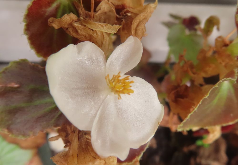

IMG_7457.JPGI prefer not to use tripod, I can not go to a excursion etc. and take tripod with me, also I chose compact camera because it is lighter and easier for use.  IMG_7270.JPGIMG_7276.JPG
These are macros with my old camera, sx620, and they look better. So I think I am not choosing correct settings with sx740, but can't figure out what I need to do.
