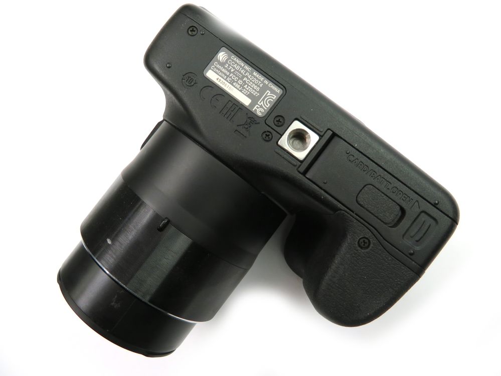

The serial number should be written on the bottom of your camera and it should be on the receipt you need to provide proof of purchase to register the camera.

As to your serial number... It should be located as follows:
Every camera should have such as sticker.  If you don't have it, why not?  Did you get the camera new, and from an authorized Canon dealer?
