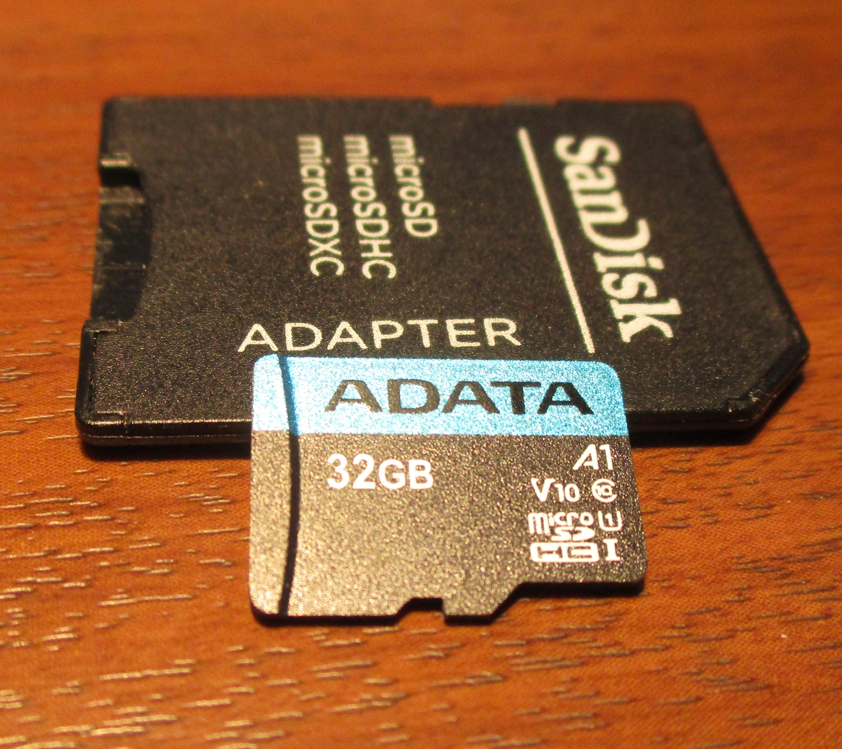

07-27-2020 05:36 PM
I was using this micro SD combination:
07-28-2020 10:45 AM
The Micro SD cards requiring the use of an adapter have frequently proven to be "glitchty" for camera use. They just add another set of electrical contacts that can cause problems with communication between the camera and memory card.
Try a full-sized, brand name SD card (formatted in the camera) from a reputable source. Amazon and Ebay seem to be flooded with counterfeit cards of questionable quality. Try buying from a local camera shop or "big box" electronics store in your area, if possible. Even an 8 or 16 GB card should be sufficiently large unless you're shooting a great deal of HD video with this camera.
