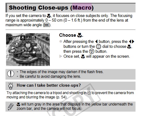

According to the Powershot SX40 HS manual:
"If you set the camera to (flower), it focuses on close subjects only. The focusing range is approximately 0–50 cm (0–1.6 ft.) from the end of the lens at maximum wide angle.”
So I cannot be holding the lens too close.
Also I wait till I see the “box” turn green.
My question is how to get it to focus on the flower in the center of the screen in the “box” instead of the ground, which is outside of the box.

Try setting your Focus mode to Flexizone as described on page 87 of your manual then position the focus frame and frame size on your object as described on page 88 of your manual. Use a tripod/monopod whenever possible also for the best results. I own the SX50HS which is very similar to yours, I don't think you have the option of using a remote shutter switch but if you do then that will help a lot also.

But trying it on my desk indicates that shrinking the rectangle seems to have solved the problem.
