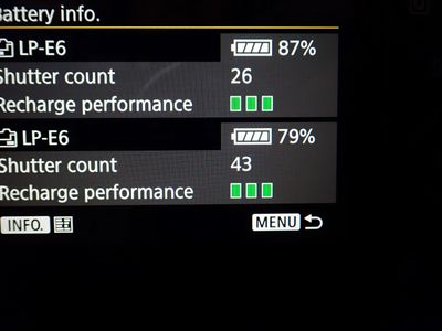

As you wrote: "I was wondering if the camera battery is like a car battery where you can charge it, but it still doesn't have enough power." A 'lens error' can be caused by not having enough energy to drive the lens motor, hence my response. As camera batteries age their recharge potential drops. This can be seen in the bigger DSLR units where the battery charge screen shows this.

My camera does not show the battery level on it. I know that, hence my comment that the feature appears on more expensive DSLR units, but I was proving my point that battery charging degrades over time and Canon recognizes that in those displays - if you really want me to, I can find a screen display that shows the batteries I put in have degraded, but it's a pretty well-recognized phenomenon. A clue is often that the battery may appear charged, but when taken out and put back in again, it starts indicating a charge again - hence my other comments. That was all.
