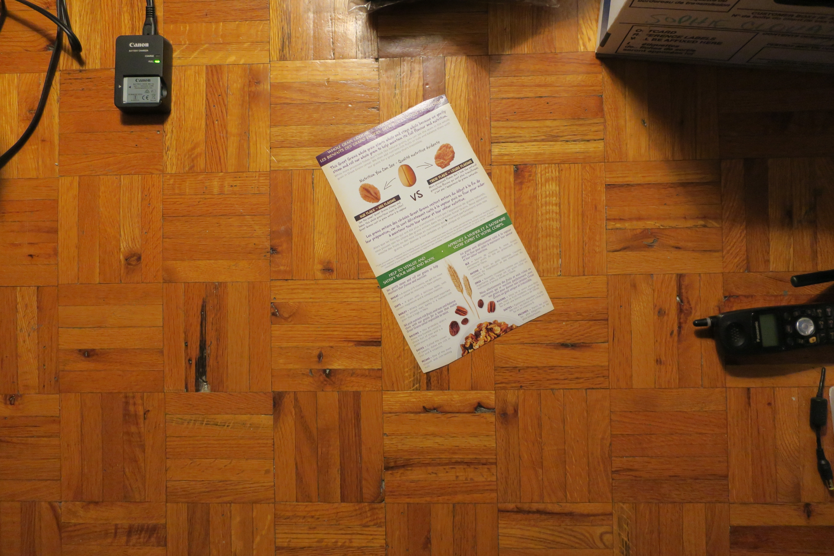

I just bought a PowerShot G9 X.
For close range photos the center focus is good, but the edges are out of focus. I've partially overcome this effect by selecting an edge for the focus frame, but then the center is out of focus though not as bad as the edges were. No matter what I try the focus is uneven and makes for bad close range photos. This camera is brand new.
My older, lower-end PowerShot A2500 HD manages to focus the whole shot evenly. See the attached photo comparisson.

I took several different shots and they are all like that. There was a bit of improvement at acute angles, where there normally should be problems. Yes, I deliberately set it to macro mode for some of the tests, with the same result. I tested at distances from 5 cm to 1.5 feet and the effect is still there. Longer distances seem also affected but much less.
Here is a shot with me placing the focus frame on the edge, I don't remember if it was right or left, but either way improves the edges somewhat but blurs the center.

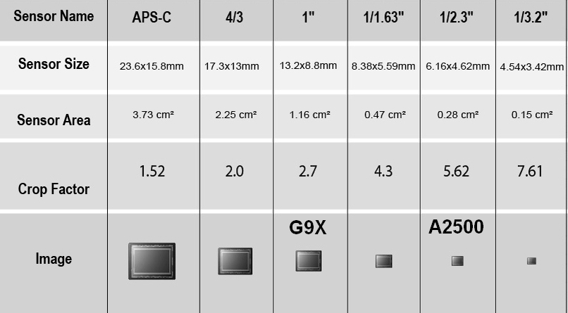

One thing to note is that the G9X has a much larger sensor than the A2500, and that means less Depth of Field for a similarly framed image. That could explain why the A2500 is better able to get sharp corners.
