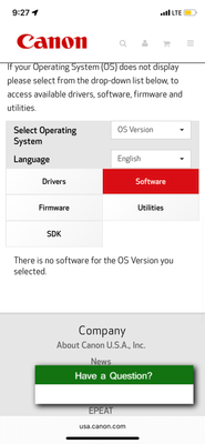

Thank you so much for the response! When I took your advice for the USB connection and software instillation, I received this message on the Canon website
It’s saying there’s no software for the camera I selected. Can you help me with this?
Thanks again!

Hi there,
In the screen capture I see that the operating system selected is [OS Version]. This would cause the site to not list any software since there is no operating system selected. If you click where it says [OS Version] you can choose whichever operating system your computer is using and it will show you the appropriate downloads below.
