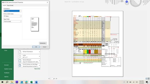

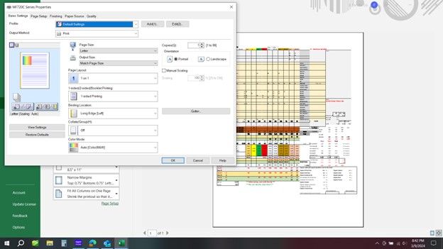

Hoping someone can help me with this.  I have an existing Windows 10 Asus laptop that prints to our Canon Image Class, flawlessly.  Just purchased a new Windows 11 Asus laptop and kept getting an error notification when printing and noticed print jobs getting stuck in the queue.  Thought maybe it was Windows 11, so returned that laptop and purchased a Windows 10 laptop.  Now, getting the same error.  Jobs getting stuck in the queue.
I just noticed on my new laptop, when printing in Excel, in "Printer Properties" it looks much different depending what laptop I'm using.  My older laptop, it is very detailed.  In my new laptop, it is very generic.  See screenshots.canon new laptop.jpgcanon old laptop.jpg

Based on your revised post, it appears that you do not have the printer's drivers installed.  This is likely the reason for your issue on both devices and why the print dialog looks different from one device to another.
To resolve, please remove the printer from your computer and restart the system.
Run the full MF installer I provided a link to, then install the MF Scan Utility.
During the installations, you will be prompted to allow the programs to make exception in Windows firewall.  This is necessary for proper installation.

Do you see those screen shots above?  Maybe that will help.
