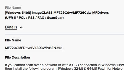

Based on your revised post, it appears that you do not have the printer's drivers installed. This is likely the reason for your issue on both devices and why the print dialog looks different from one device to another.
To resolve, please remove the printer from your computer and restart the system.
Run the full MF installer I provided a link to, then install the MF Scan Utility.
During the installations, you will be prompted to allow the programs to make exception in Windows firewall. This is necessary for proper installation.

The full MF drivers package v4.803 are identical for Windows 10 and W11. Is this the one you are using for install?
This and the MF Scan Utility v1.21.0.2 are what I'd use.
