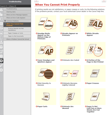

04-05-2024 09:45 AM - edited 04-05-2024 09:47 AM
Greetings,
With the exception of high-humidity environments, printing which appears lighter than it should is often related to the toner, paper type or print density settings.
Toner: Using Canon toners is recommended. Using 3rd party products can have unexpected results. The remaining toner level (if low) can also affect print quality.
Paper type. Make sure your paper is correct type and quality.
Print Density settings don't usually need to be adjusted. You can adjust toner density following the instructions in the printer's User Guide.
You can download the manual from the product's Support Portal.:
Canon Support for Color imageCLASS MF726Cdw | Canon U.S.A., Inc.
See troubleshooting, when you cannot print properly:
