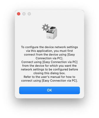

Greetings - I recently relocated to Japan and purchased an MF272dw printer. I have it connected to a Macbook Air running OS 12.7.6 using a new USB cable. The printer shows up in preferences, and when I attempt to print a PDF it also shows up in Print. When I hit the print button nothing happens. WhenI check the printer in preferences it shows "in use, last used". Open Print Queue shows the file and "Printing - looking for printer" with a blue bar cycling back and forth. Needless to say this is frustrating. I've used many computer/printer combos and have never had this much difficulty.

I'd start over. Disconnect the USB cable. Remove the device from printers and scanners applet using the minus key (-). Restart your Mac. Run the setup utility and do not connect your printer until prompted to do so by the installer.

Hi Rick - yep, but the Canon Laser NW Device Setup Utility pops up a box that says to configure the device using 'Easy Connect via PC'. When I hit OK, nothing happens and I can go no further.
