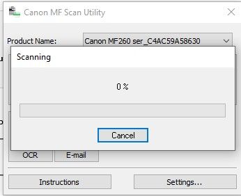

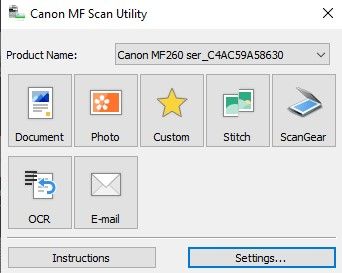

Hello Rick and thanks for letting me know the updated file was now available (I can tell because the icons are now in color). I downloaded and installed it with no problem. But I still have the same problem that I had before: When I click the Document icon in the Scan software (see image with colored icons), I hear the gears move in the scanner and a light buzz, but then nothing. The scan progress bar doesn't move (2nd image), and the green light on the scanner is flashing, the orange error light is glowing, and the info window tells me to turn off the main power and try again (which I've done, including removing the power cord and also rebooting the computer). It doesn't matter if the document to be scanned is on the glass or the feeder, and the machine does print documents. After a few minutes an error message pops up with error code 110,0,0. So do you have any further suggestions? This literally happened overnight. One night it worked, next night it didn't. Thanks in advance.

The error message with the behavior you describe could be a hardware fault with the scanner. Are you able to scan from the printer's LCD? Also check your paper settings.

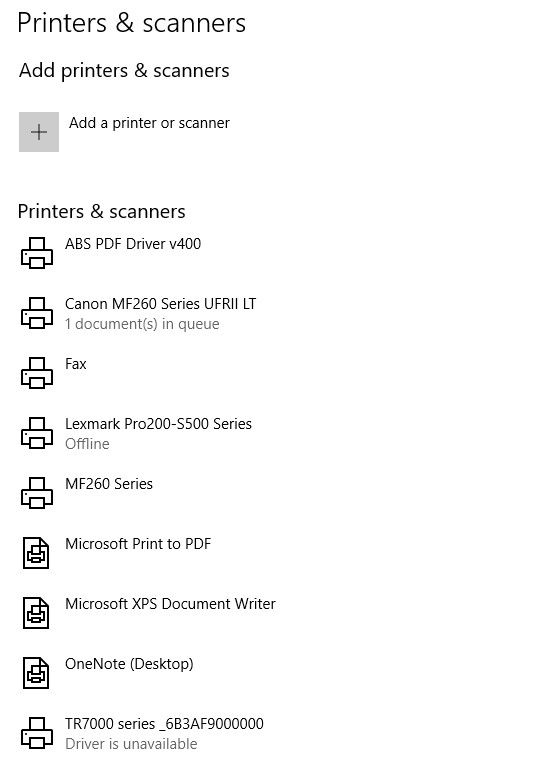

Hello Rick - As far as I can tell the paper settings are correct, and the 260 is the only device showing in the drop-down menu. Here's a screen shot of the devices under the windows/settings/devices/printers and scanners. I see an old Lexmark in there, I can remove that, but what other devices should I remove? I see the 260 in there twice btw. And I don't know why one of them says "1 document in queue". What do you suggest? Thanks
