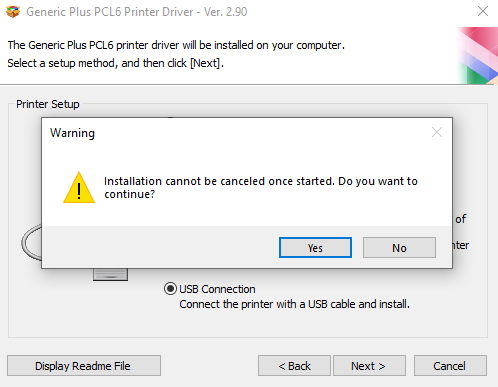

We even noticed that the driver doesn't install properly when the printer is connected via USB.
That how the installation goes:
Step 1: Here I choose the obvious "Next"
Step 2: On the next step I'm prompt to choose the connection which is used in our case it's USB and I again click on "Next"
Step 3:That's the next screen and I click "Yes".
Step 4: At this moment the installation starts and the first step is to discover the printer.
On this step I also connect the cable to the computer via the USB cable and start the printer as shown in pictures 1,2,3.
It's also seen that it has appeared in "Devices and printers".
Step 5: However after a couple of minutes the printer is not found and the installation cannot continue.

‎11-01-2024 11:24 AM
Hello GeorgeAR,
If the installer is not detecting the printer during the USB install, you can try removing any stored connections for the printer and then try reinstalling the driver from our support site.
While the printer is connected to the computer, you can press the windows key and the letter R on your keyboard at the same time. In the run box that appears, you can type in devmgmt.msc and click ok. In the device manager window that comes up, you can click on the option for universal serial bus controllers. You can right click and uninstall any connection for USB printing support that appear or any connections that show the printer's name.
Once the connections have been removed, you can disconnect the USB cable and try the install again. You can download the RECOMMENDED driver install from our stie using the link HERE. When the install prompts you to connect the USB cable, you can reconnect the printer to your computer.
If you continue to have issues, I suggest contacting support over the phone at 1-800-652-2666. Our agents would be happy to help.
