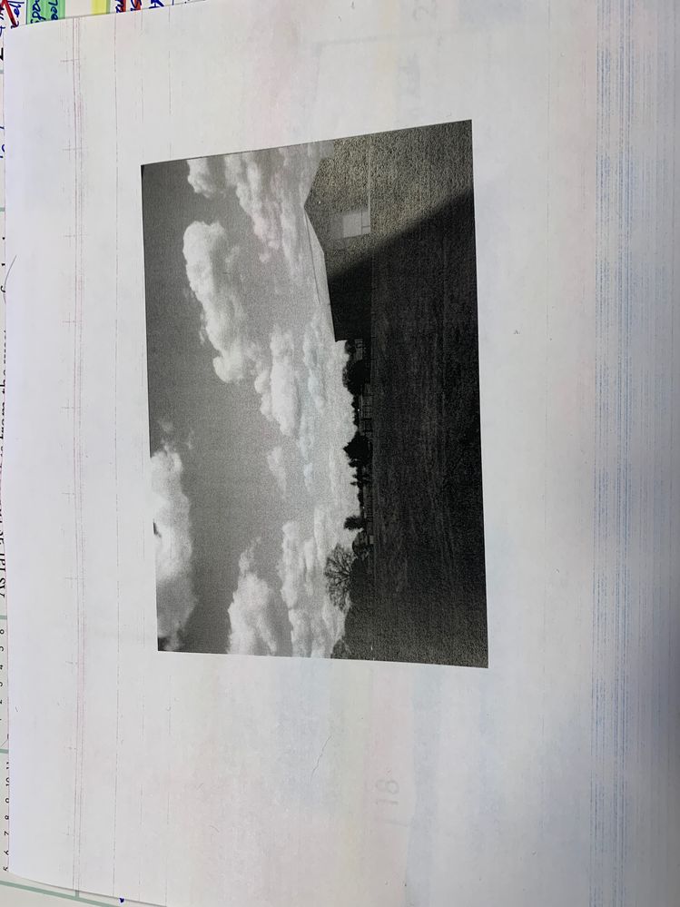

canon printer mf731cdw printer streaks. how can I solve this problem. ThanksIMG_0465.jpeg

Hello Toddprice,
The issue looks like the ITB or Fixing assembly needs to be cleaned. You can perform the cleanings using the steps in the link HERE. If that does not resolve the issue, you can try reseating the toner and checking the inside for any loose toner powder that you can wipe up with a damp cloth.
If that does not resolve the issue, it looks like the printer needs service. You can use the link HERE to access you My Canon account or you can contact support at 1-800-652-2666 to check your service options.
