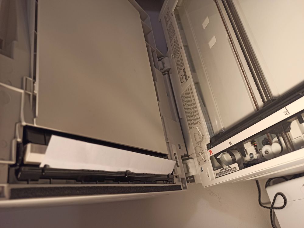

When I try to scan with ADF, the paper comes off fine but then stops, always in the same place. There is no jammed paper debris.
The error code is 103,0,0.
Solved! Go to Solution.
01-10-2022 04:14 PM
I found the solution. It is the plastic tab (with red arrow) on the glass that is blocking. A small piece of adhesive tape, cut with a cutter and it's good.
