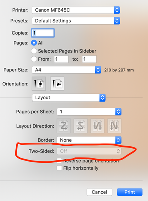

12-29-2021 09:55 AM - edited 12-29-2021 10:12 AM
Hi Hector. I'm having the same issue on my Canon MF645CX. Is there an option for the Canon driver to use the normal selection for 2-sided printing (circled in red in the screenshot)?
The workaround you posted with going to Printer Features > Finishing > Print Style works (now my printer ONLY prints duplex until I dig back through the menus to set it to 1-sided) but it's unnecessarily cumbersome (4 clicks in a submenu instead of 1 in the main menu). Plus, withouth digging through the menus it's impossible to know whether it will print 1- or 2-sided.

The Canon Office Printer Utility detects that the printer has a Duplex unit (screenshot attached), but the driver is not passing this information on to the OS (the problem is independent of which application I am trying to print from. Preview screenshot attached for reference).

Hello Nomad,
The option under finishing, is the Canon driver option for duplex printing. The other option is part of the generic Mac driver options and does not work with the printer. Using the preset option at the top of the you can configure your settings to something you want and then select the option to save the settings as a preset. You can then switch between the settings you want without going through the menu.
01-10-2022 11:22 AM
Thank you Hector. I can confirm that 2-sided printing works now on macOS Monterey 12.1, and with the latest driver on the support page (v101910-02). When printing pdfs from the Preview application, 2-sided printing can be chosen from the "Finishing" menu.
