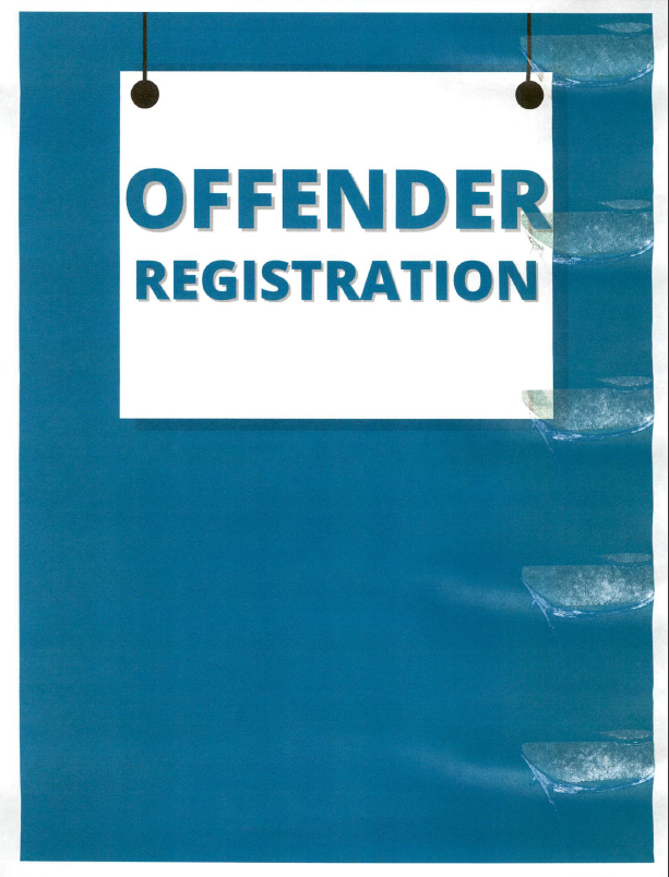

Our printer has started to have crescent shaped "ink" smudges? on printed paper - sometimes also shows creasing in paper. It is worse with color items than black and white. We regularly run the cleaning maintenance recommended and use canon toner - We cannot seem to get this to go away, help!

The issue looks like a problem caused by something in the paper feed path or by a problem with the hardware. In this situation, you can try removing all of the toner and checking the interior for any torn paper or obstructions. If the inside is clear, you can try cleaning the fixing assembly and the ITB using the steps in the link HERE. If you continue to have the issue, it looks like there is a problem with the hardware. You can use the link HERE to log into your My Canon account to check your service options or you can contact support at 1-800-652-2666. Our agents would be happy to help.
