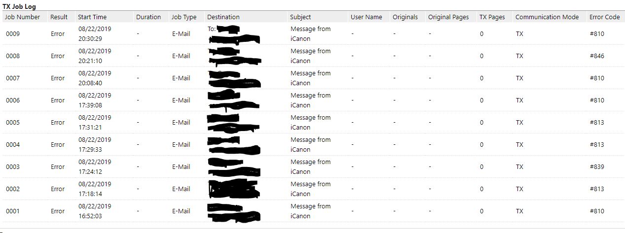

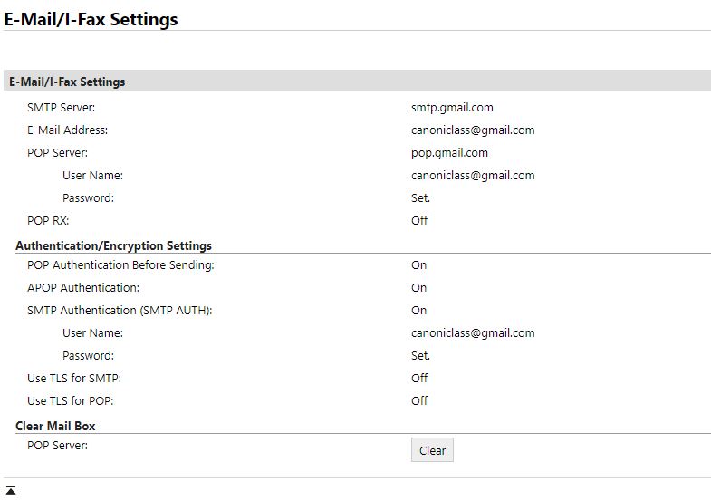

Hi peeps,
I have an issue with scan to email (Gmail) from the printer. I tried different POP and SMTP ports and protocols and seems to be nothig works. POP enabled in Gmail, no firewall, machine is in DMZ currently. Any help appreciated.
Solved! Go to Solution.
08-23-2019 09:41 AM
If you are using GMAIL:
smtp.gmail.com
Username: full gmail address
PW
Port 465 (SSL required)
Port 587 (TLS required)
Ensure you select the correct authentication type depending on the port you use.
For your own knowledge in the future. Putting a device in the DMZ doesn't help if your ISP is blocking ports. You can move it back behind your FW once you get mail working.
