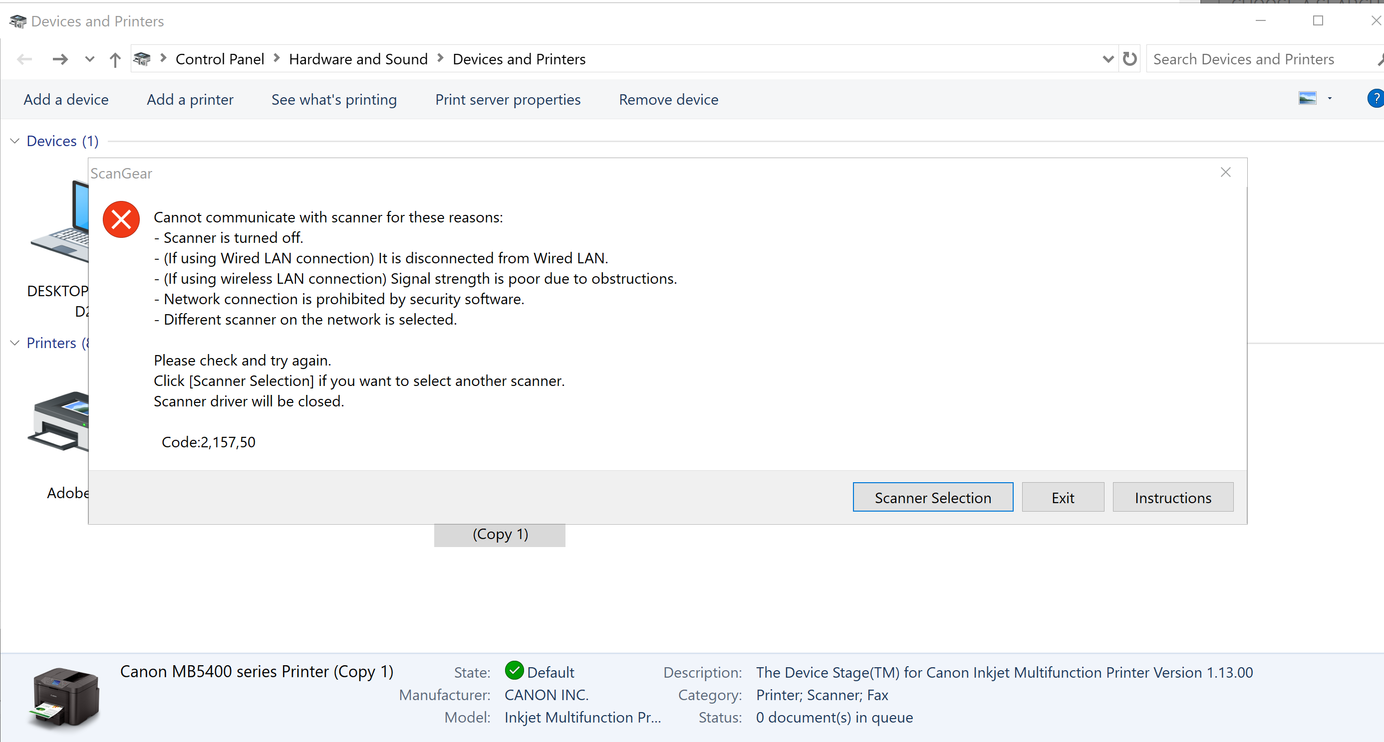

I run Windows 10 Pro, latest update. Code given is 2, 157, 50. Here is the message. I've done this being right next to the device.

Hi clawsonrbc,
The 2,157,50 error is caused by security software blocking communication from the scanner to your computer.
Let's try using USB, as you said that you were unable use this method as well.
Please follow these steps:
1. Disconnect the USB cable from your MB5420.
2. Press the Windows key on your keyboard and the letter R, then let both go.
3. In the Run window, please type CONTROL PANEL and click OK.
4. Click on View devices and printers.
5. Right click the MB5400 series and left click on Remove device. Repeat until all MB5400's are removed.
6. Click on Control Panel in the upper left corner (or the Back button).
7. Click on Uninstall a program.
8. In the list that appears, please click on "Canon MB5400 series MP Drivers" and then Uninstall at the top.
9. Follow the on screen prompts to install.
Once removed from the list, please close Control Panel and then reinstall the driver:
1. Open a web browser and go to this link:
2. Click on the Drivers & Downloads button.
3. Click the Select button to the right of "MB5400 series MP Drivers Ver.1.02 (Windows)".
4. Click the Download button.
5. Once the download is complete, please open your downloads folder and double click "m68n-win-mb5400-1_02-ea34_2.exe" to begin the installation.
6. During the installation, please select USB Connection and reconnect the USB cable when prompted.
Once reinstalled, please follow these steps:
1. Press the Windows key on your keyboard and the letter R, then let both go.
2. In the Run window, please type NOTEPAD and click OK.
3. Type TEST PAGE in Notepad.
4. Click on File and then Print. The Canon MB5400 series Printer should be highlighted. Click Print at the bottom.
Does the test from Notepad print?
If it does, please attempt to print using the IJ Scan Utility:
https://ugp01.c-ij.com/ij/webmanual/ScanUtility/W/MB5400%20series/1.1/EN/SU/Top.html

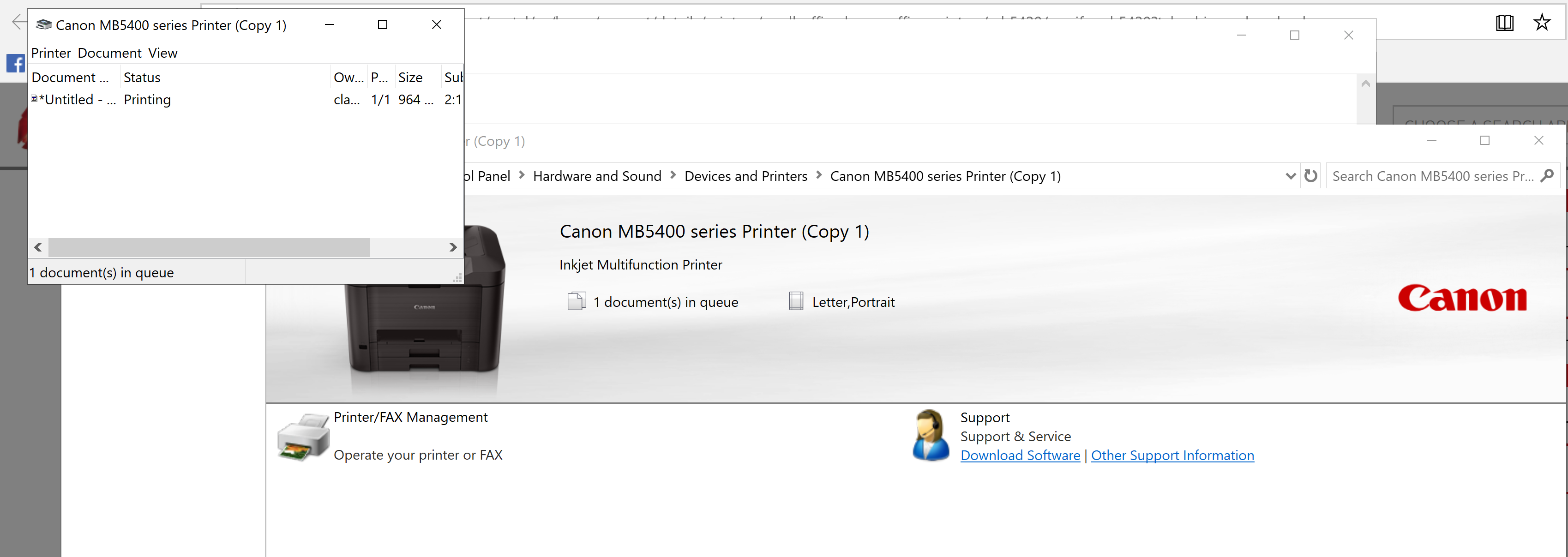

11-21-2019 02:26 PM
I did this via USB. Was able to printt and scan. Once I went wireless, I was able to print, but AGAIN, the print queue did NOT change, see screen shot. I then manually deleted the document from the print queue, and got the same error message [even though all security is still off]
11-22-2019 03:02 PM - edited 11-22-2019 03:03 PM
Hi, clawsonrbc.
Windows operating systems will treat the USB and wireless connections to the same device as separate devices. For this reason, when using the IJ Scan Utility and the MB5420, ensure the Product Name drop-down is set as following:
For USB, "MB5400 series";
On a network, "MB5400 series Network"
