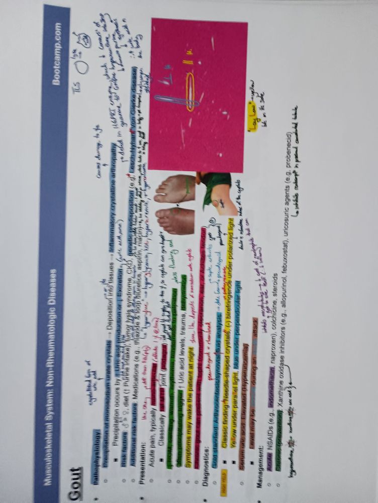

What is causing it to look like that in the print-outs? And how can I fix it?

If I believed - even at 1% level that me using some generic months ago would cause problems with genuine toner 2+ months later, I would. I only started having issues very recently. I need to check the timeline & see if it's when I switched to high yield, b/c that is a recent decision. But here are just a couple of pages from September. So I'm just not sold that generic is even remotely related. I *am* sold on going back to HP when I do decide to get a new printer. This printer was cheaper out the gate, but the toner is a lot more, the print quality is not better, getting service is harder, and if generics really can just destroy a printer that wouldn't destroy its competitor, then that's a serious design flaw to run from.
