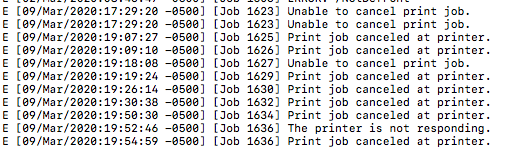

I can print other PDFs.  I can print word docs.  It just seems every so often there is a PDF it just won't print.  Thinking the file may be too big I've even broken them down into 1 page PDFs and stil lthe same thing.  Screen Shot 2020-03-09 at 8.12.22 PM.png
No error code.  I can't figure this out yet it's frustrating as all get out.

When I view the log, I see:
E [05/Aug/2020:14:51:06 -0400] [Job 111] Print job canceled at printer.
E [05/Aug/2020:14:52:36 -0400] [Job 112] Print job canceled at printer.
E [05/Aug/2020:14:56:56 -0400] [Job 113] Print job canceled at printer.
