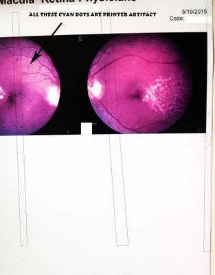

Hi. I think I have the same problem.
ImageClass 8350cdn.
I tried your steps above and it didn't improve. I want to get your opinion on whether I have the same problem or should I seek a different solution.
Let me describe it completely.
Dots are all cyan and appear in about 15 irregularly spaced columns down the page. All dots repeat exactly at 27mm (measured vertically) intervals.
Most of them are faint/small on unprinted white parts of the page, but very dark and larger over images.
The rightmost column is less than a mm from the edge of the sheet of paper.
Below I made an ASCII cartoon of my problem. I'm happy to provide an image if this is not clear.
Thank you for your opinion!!
Andy
