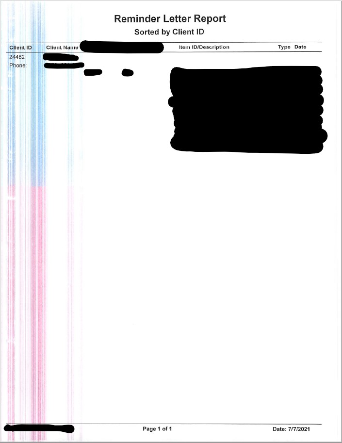

Hello all,
I support an ImageRUNNER ADVANCE C256 III printer that has streaks on the left side of the page. I've done the following as troubleshooting.
1. Replaced the toner cartridges and the fixing assembly. We only use OEM parts and not refurbished.
2. Ran maintenance and cleaning, which cleans up the lines for a while but after some use, they show back up. The issue does appear to go away if you print a large job, but comes back after a while.
Below is a screenshot of what a print out looks like. What might be causing this type of issue and what can be done to resolve it?
Thanks in advance.

I'd also like to add that the Toner Cartridges have been changed several times since the issue started.
Could the issue be tied to the Transfer belt?
All of the drums were replaced in February of 2021 as well.
I did replace the transfer belt, and it fixed the issue. No thanks to this forum.
