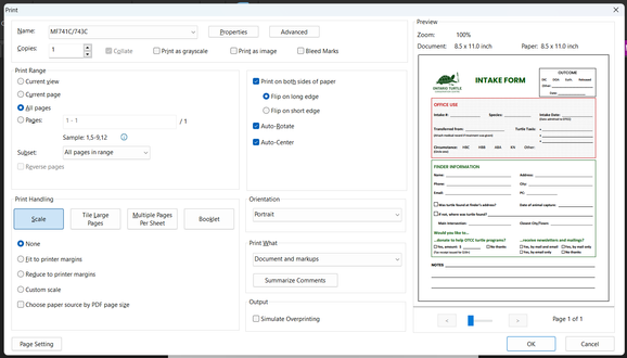

Hello! I have a Canon ImageClass MF741Cdw and Windows 11. When I print multiple copies of a one-page document, each page is pulled back into the printer and through the duplexer even though only one side is printed on. As has been suggested in other threads, I made sure <Switch Paper Feed Method> is set to <Speed Priority> for all sources. This has the effect of the last copy not being pulled back in, but if I'm printing 100 copies, the first 99 copies are pulled back in.
I can manually de-select 2-sided printing within the print interface, and that solves the problem for that print. But it would be nice to not have to do that for each print.
Is there a way to accomplish this?

This happens with both .docx and .pdf files (printed from Microsoft Word and Foxit PDF Reader respectively). I believe the driver is "Canon Generic Plus UFR II V250" (screenshot 1). Also to be clear, this happens when "Print on both sides of paper" is selected AND printing multiple copies of a one-page document (screenshot 2).
Scenarios I've tested, all with a one-page document:
  • "Print on both sides of paper" is NOT selected, one copy printed - not fed through duplexer.
  • "Print on both sides of paper" is NOT selected, multiple copies printed - not fed through duplexer.
  • "Print on both sides of paper" IS selected, ONE copy printed - not fed through duplexer.
  • "Print on both sides of paper" IS selected, TWO copies printed - first page is fed through the duplexer, second page is not.
  • "Print on both sides of paper" IS selected, 100 copies printed - first 99 copies are fed through the duplexer, last page is not.
I know I could just de-select "Print on both sides of paper" each time, but I would rather not have to remember to do that each time, when it seems there may be a setting to fix this. Thanks in advance for any help!
