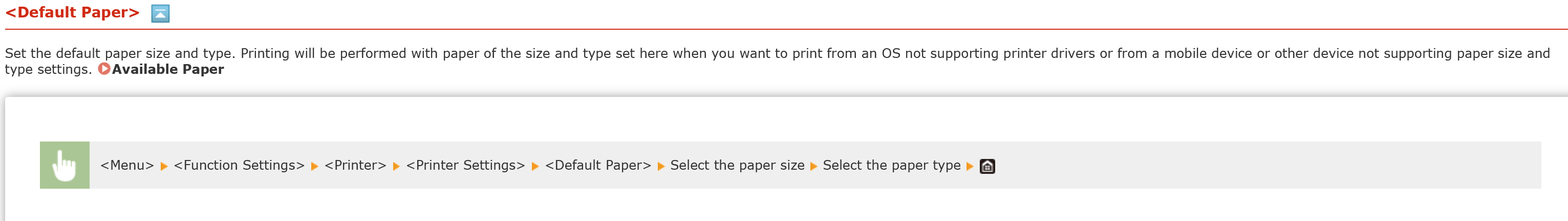

Greetings,
Hopefully this will help.
<Menu> <Function Settings>
<Printer>
<Printer Settings>
<Default Paper>
Select the paper size
Select the paper type
Here's your online manual

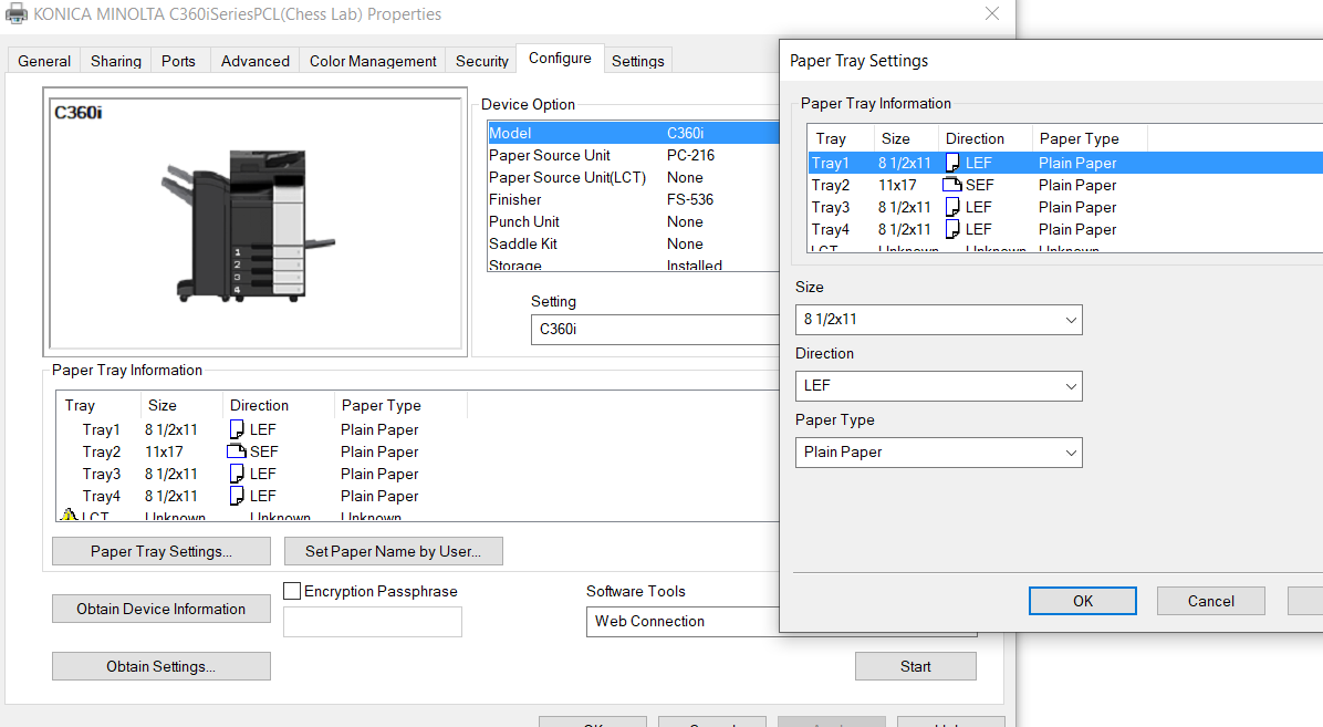

Greetings,
Then it sounds like you may have unintentionally changed the default paper selection or size to something other than or whats loaded in Tray1? Look at the printer preferences (Driver) on the computer.
Here's an example
