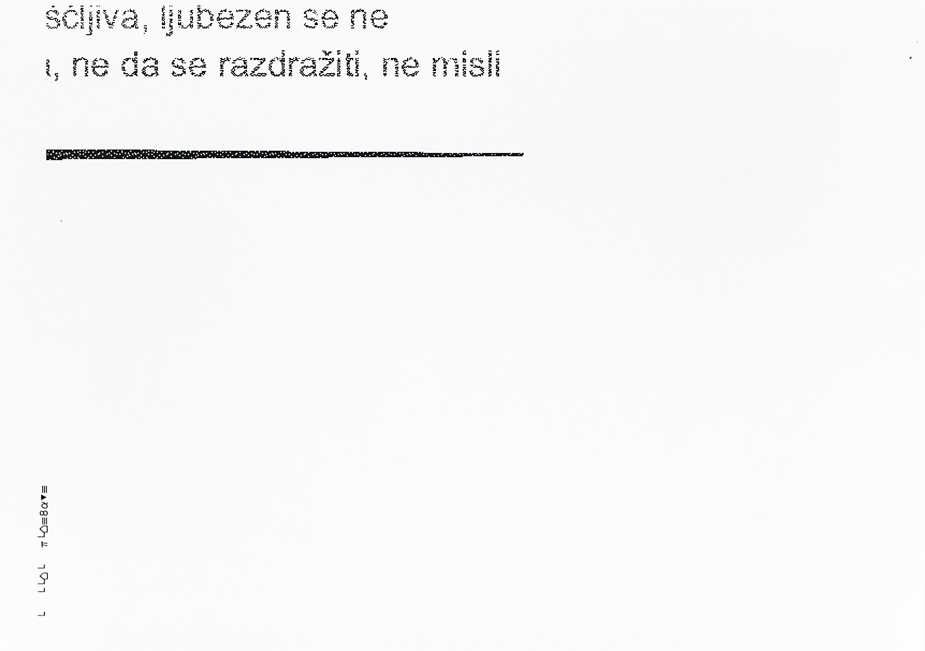

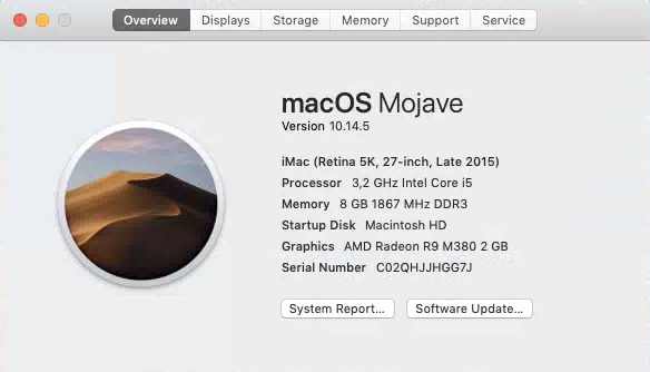

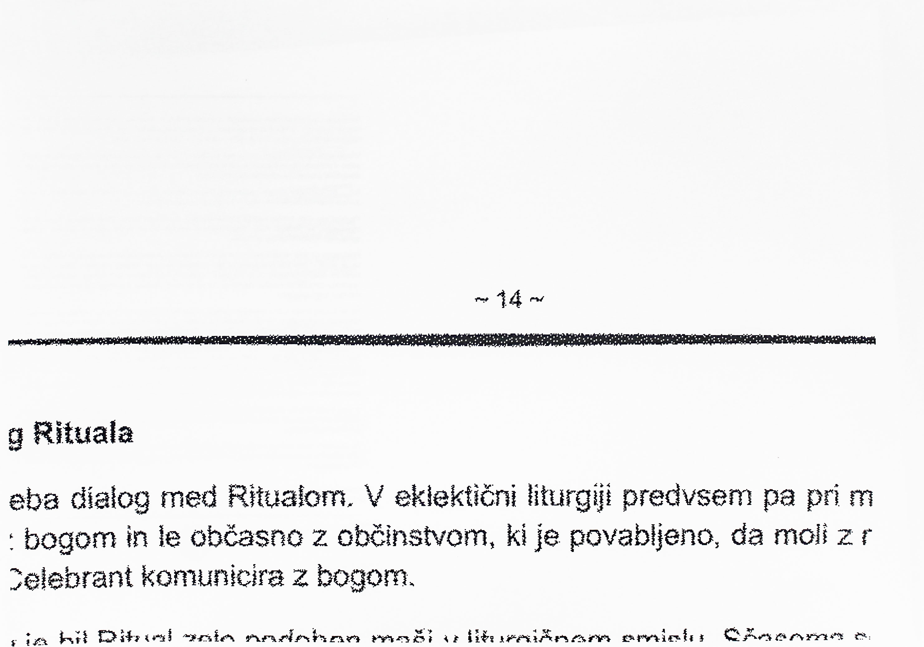

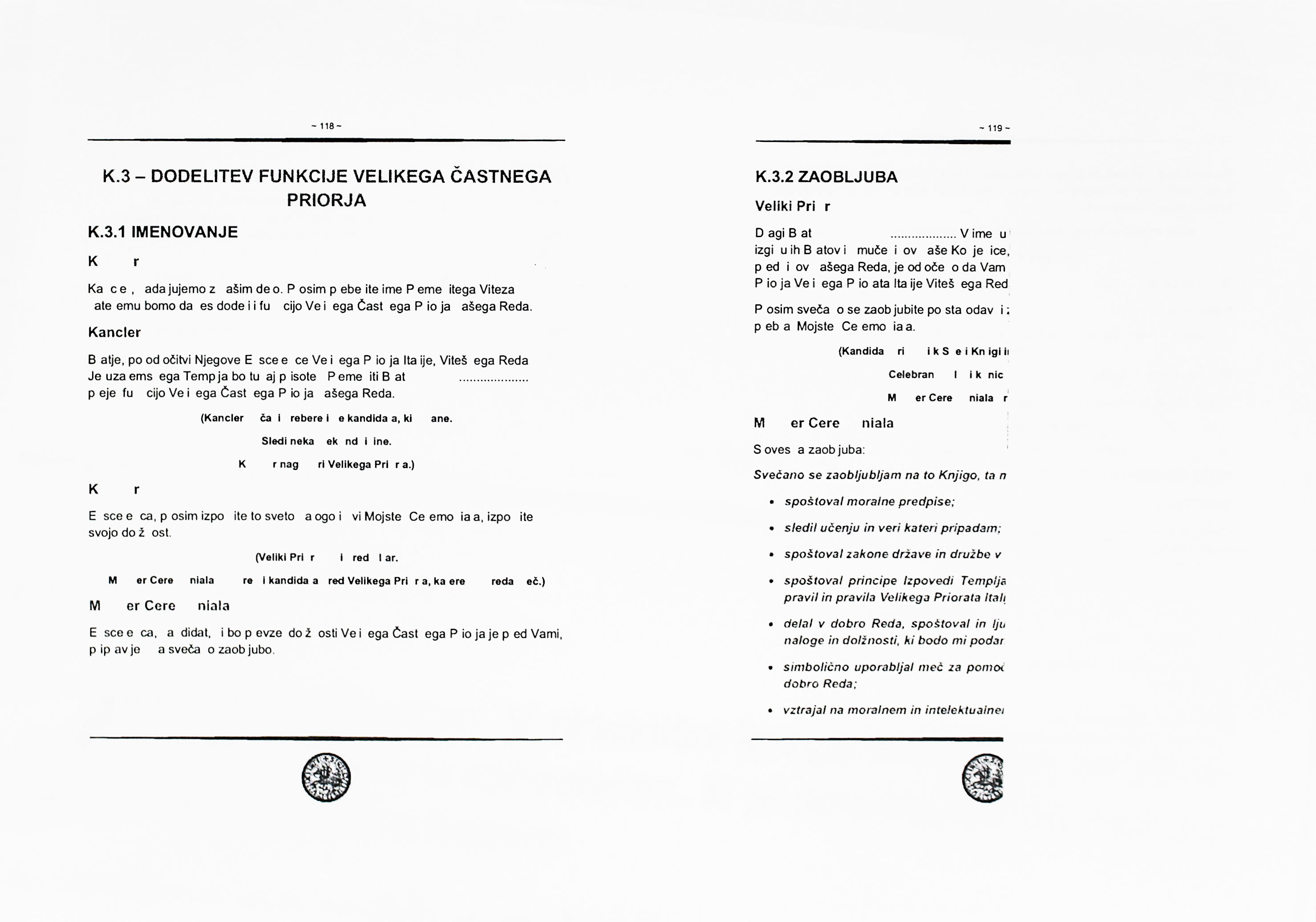

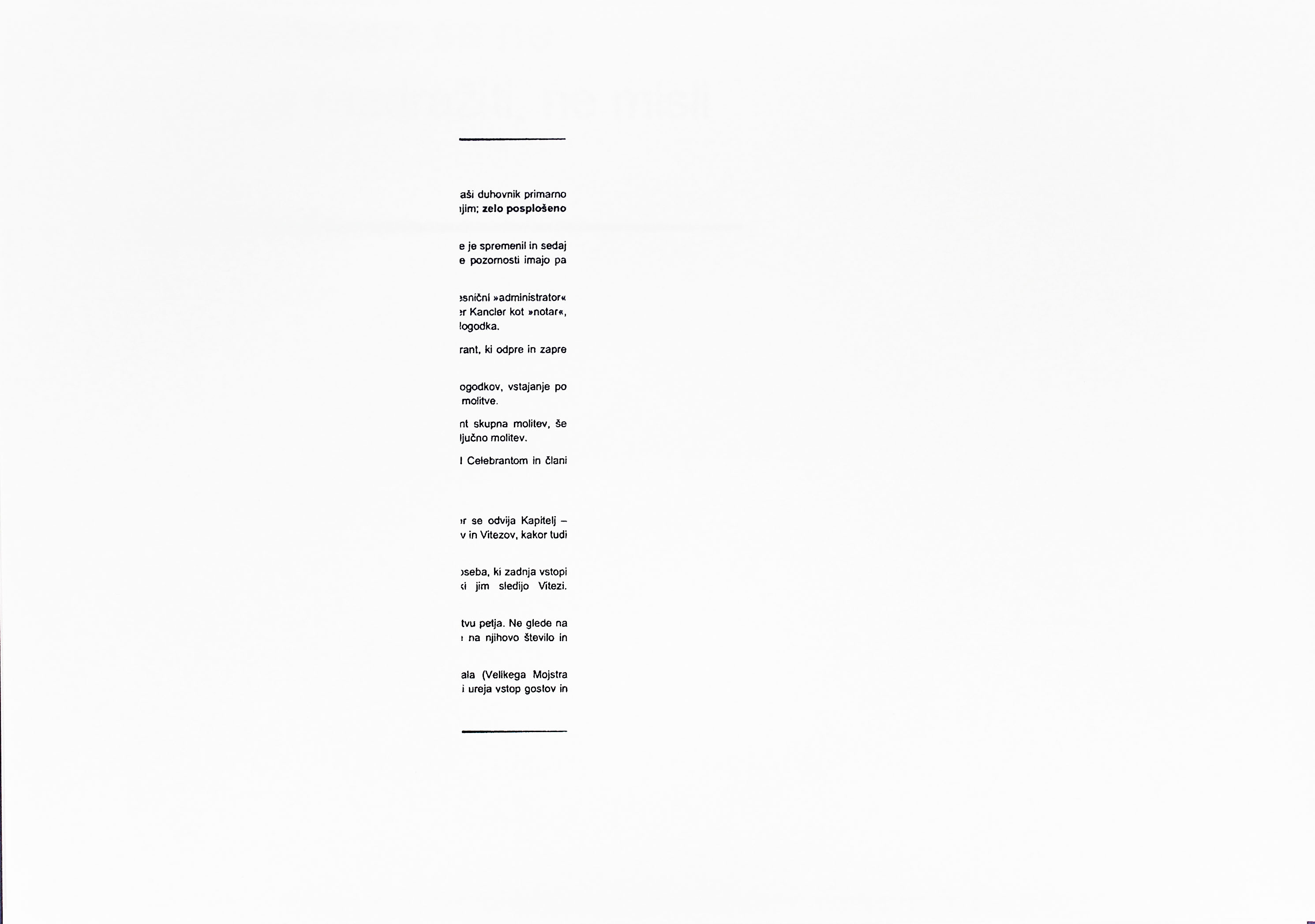

Hi, we are having problem with the Canon iR 1022iF printer. It started to behave strangely when printing multiple-page PDF files. From the attached samples of print, you may see that some letters were not printed, prints have been scaled up and cut off. Our iMac computer is using macOS Mojave version 10.14.5 operating system. I tried to install the latest driver here:
https://www.canon-europe.com/support/products/imagerunner/ir1022if.html
However, this driver does not support duplex printing like his printer is capable of. So the only option that I had was to install generic Apple PCL driver 2.1 for this printer. Until recently we were able to print all document just fine, including duplex using this driver. However, now the printer is behaving like crazy and we do not know what to do.
Is anyone else using the same printer with a combination of official Canon driver and OSX system and is able to duplex print?
