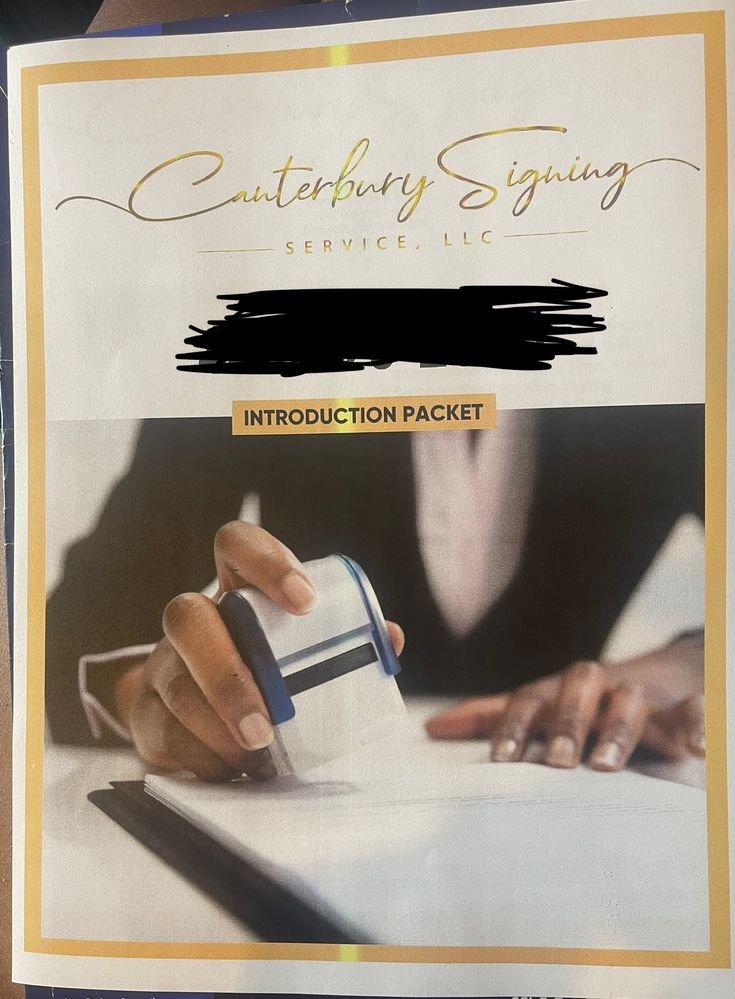

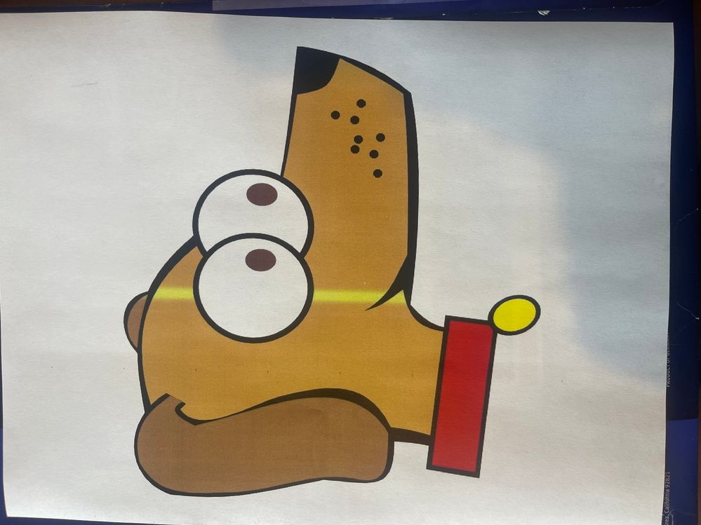

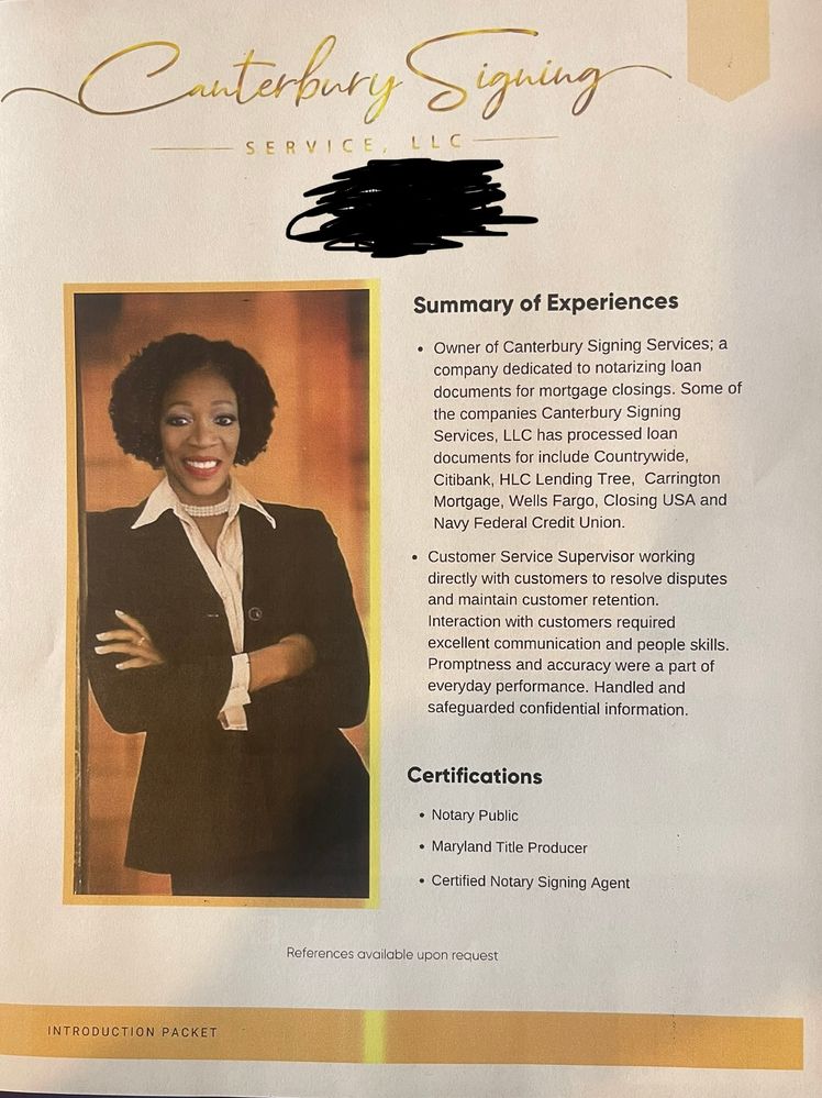

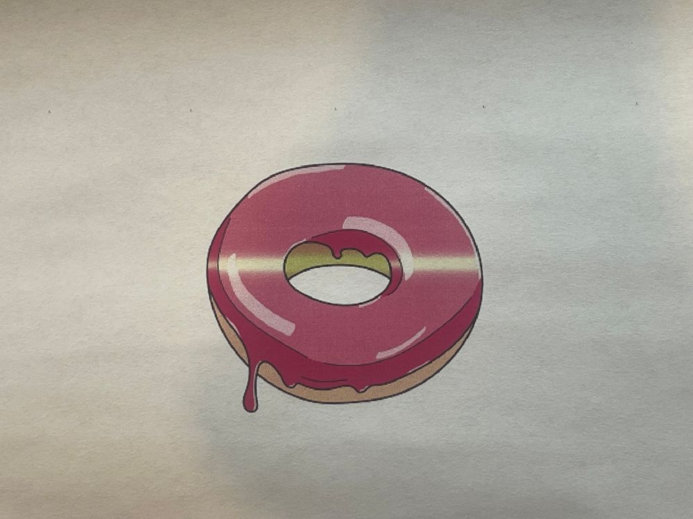

My printer prints a yellow line down the center of any document that i print in color. Black and white documents print fine. Online searches for a probable cause has turned up nothing. Hopefully someone here can help me resolve this issue. I have attached samples of documents I have printed.

From the image that comes up, it looks like the yellow toner might be fine. In this situation, I would suggest removing the toner cartridges and checking for any obstructions. If the inside is clear, I would suggest checking the magenta toner cartridge for any issues or replacing it to see if it resolves the issue.
The image that you posted shows that the yellow toner is being applied evenly but the other toners that would finish whatever color it should be are not applied. The brown on the dog, the doughnut and the gold in the border would be yellow if the magenta was not applied.
