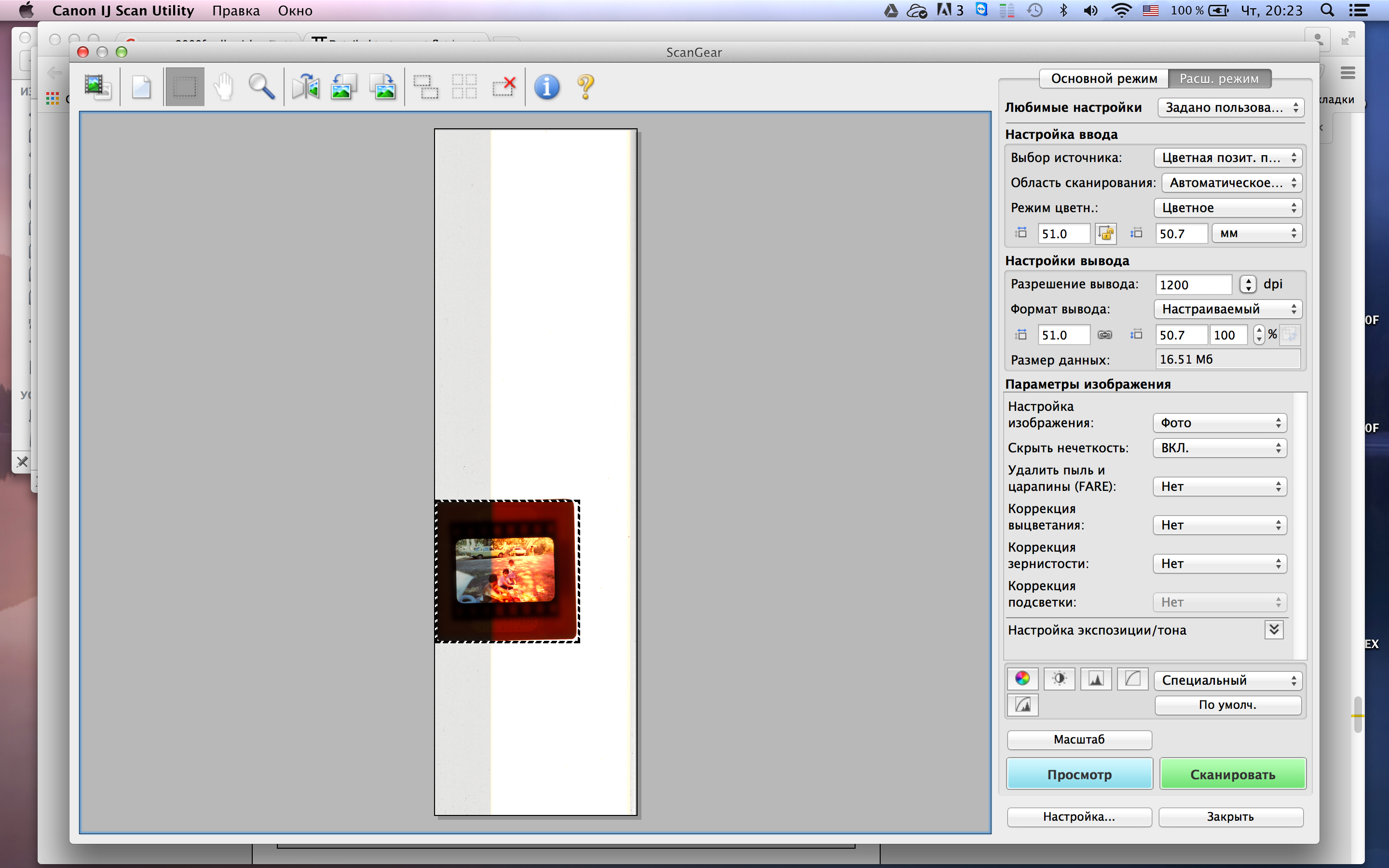

Recently i start scan my old archive of color slides. And scanned about 10 of them and the i had strange problem with color of slides. It all become orange-colored. Then i moved slide a bit and noticed that half of slide is normal and other is orange. When i make a preview it lookes like lamp is very bright on that area where is orange. What can it be? Lamp problem?
02-18-2016 02:12 PM
Fixed! Scanner calibrate the lamp each time and the space on the top need to be free. Now it's ok! It seems that i put slide on top with "calibrate ech time" option enable, and after scan when all goes orange i disable that option all slide become orange too.
