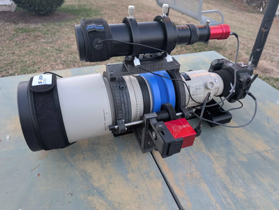

Here's a photo of the monstrosity that then goes on top of the mount:
