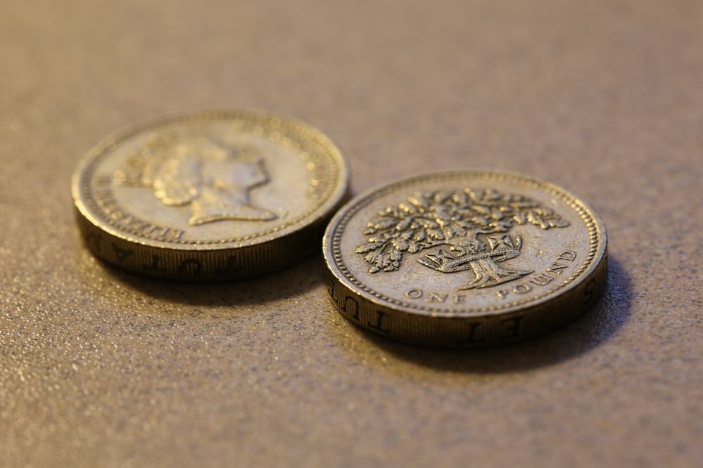

Donnie, here are a few examples (and please exuse the poor lighting and color balance - these were thrown together quickly for demo purposes.)
Here's a couple of British Pound coins to show what happens with the lens.
This image was taken with a Canon 5D III using a Canon EF 100mm f/2.8L IS USM Macro lens.  The lens was set to f/8 for this exposure.
f/8 would normally provide a decent depth of field... but look at what happens with this image:
Notice that the middle area of the coin on the right is focused, but but the front and rear edge are out of focus... and this is at f/8 -- keep that in mind.
I wrapped a piece of masking tape around the focus ring on the lens.  I focused for the front edge of the near coin and used a marker to mark that position.  I then adjusted to the rear edge of the far coin and marked that as well.
I then took a series of exposures from the front focus mark to the rear focus mark tweaking the lens just very slightly between each exposure.   A total of 10 exposures were taken.
I then used focus stacking software (in this case I used Photoshop's "Photo Merge" capability)  By merging all 10 photos, the result is this photo:
Look carefully and you'll see the desk in the near foreground and distant background are still blurred but the coins are sharp from front to back.  In reality I needed more images.  This can be done by very gently tweaking focus between each exosure or by using a "focus rail" ( a track-like device that you put on a tripod and then mount the camera to the rail and it moves the whole camera forward or backward in an amount you can control for careful macro photos with focus stacking.)
This was a 100mm macro lens on a full-frame body (and frankly I could have been much much closer with this lens) but with an APS-C crop-frame body (such as any "Rebel" or mid-range model) the EF-S 60mm macro would have provided a very similar angle of view.
The SX50 HS and SX510 HS appear to have good minimum focus distances... so they may be able to achieve the results you want, but regardless of camera, I suspect you'll need to do focus stacking for good results (I used Photoshop but there are many applications that can do this including applications which are specifically designed for macro photo focus stacking.)
These images are reduced for web-posting purposes, but the originals are absolutely tack-sharp and you can see every little surface texture.
