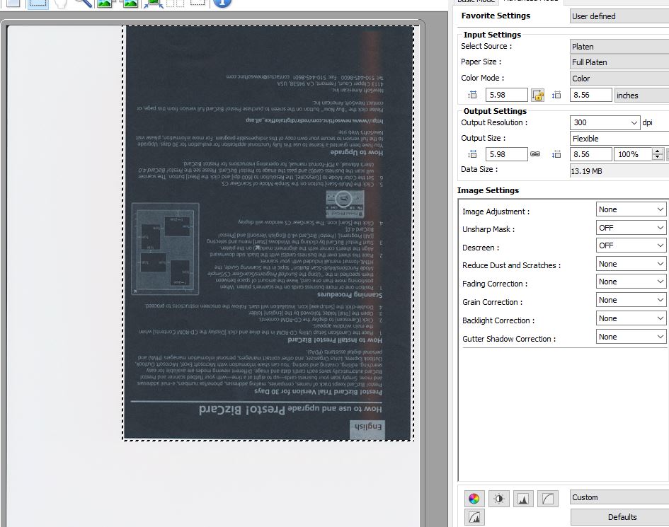

I am getting wide light (orange or tan) streaks on scans of anything dark (photos, flat black paper) that are positioned on the left side of the glass. The streaks appear in the range of 1-2 inches from the edge of glass. No matter what I have tried, I cannot prevent the streaks from appearing when I scan something. If I put nothing on the glass, and just scan with the lid shut, then I do not see the streaks.

Here is a screenshot example of the issue, shown via the preview feature in ScanGear. The target is a flat black piece of paper with silver ink printing. The orange glow streak running down the right side of preview is generated by the scanner; the orange discoloring is not part of the target.

As promised, Canon sent a replacement 9000F MkII. I am happy to report that the replacement does NOT have the light streaks problem. I guess that I can chalk this up to problem that is affecting SOME units. The correctly working unit has a serial number in the 53xxx range.
A screen shot of the correctly working scanner (no light streak):
