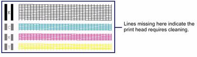

A test of the printer should be performed.  The Nozzle Check pattern shows if each print head nozzle is operating properly.  Please perform the following steps to print a Nozzle Check pattern:
1.  Turn the printer on and make sure paper is loaded into the sheet feeder.
2.  On your printer, press and hold the RESUME button until the printer light blinks twice. When you release the button, the Nozzle Check pattern will be printed.
3.  After the Nozzle Check pattern is printed, compare the results to the example that has been attached below.
4.  If any colors are missing or if any horizontal lines appear in the color bars, perform the print head cleaning procedure.

Once you have completed two cleanings, please perform another Nozzle Test.  If colors are still missing, turn off the printer.  After 24 hours, turn the printer on and perform one more cleaning.  Once the cleaning is complete, print another Nozzle Test.

Thanks for your response.  I did the cleaning thing again and again.  I put new cartridges in the printer but still the same.  So I contacted Canon as you suggested and their very non-eco response was that they would give me some sort of discount on a new printer.  Not sure how that would work when I live in Ireland!!  So I went to the internet for help and found some interesting things about cleaning the printhead with hot water or alcohol.  I did both a couple of times.  The alcohol seemed to work best.  Then I did the cleaning thing again a couple of times and I now have a fully working Bubblejet i80.  Nice that it didn't have to go to landfill.
